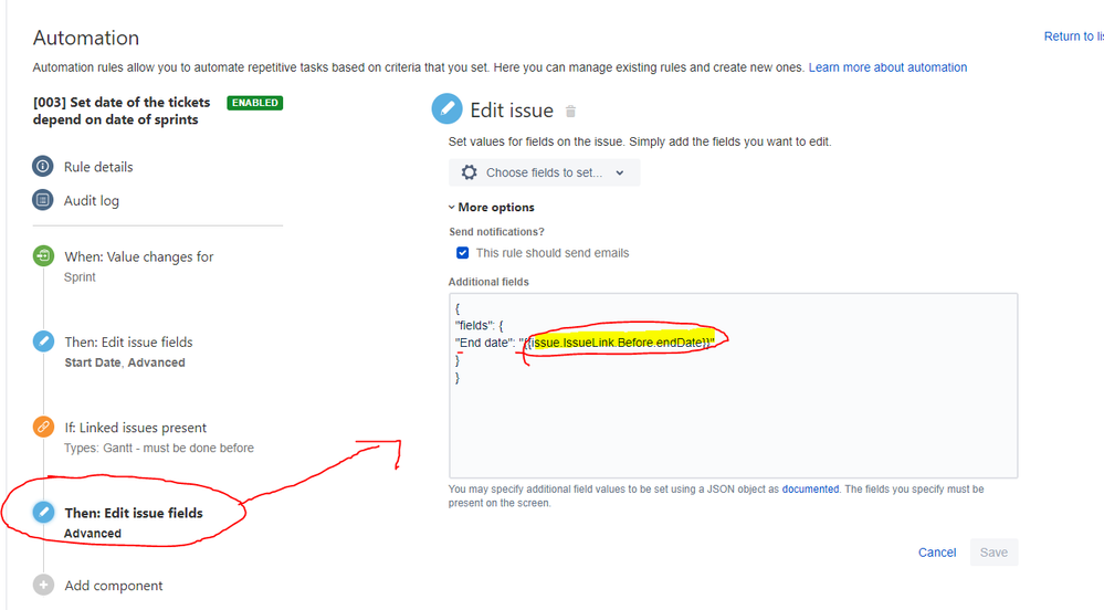

I have a ticket, it has 2 linked tickets as below:
I am trying to create a rule that the main ticket will be automated set the End Date of linked ticket (Gantt - must be done before). Here is my proposed rule, but I don't know how to refer to End Date of linked ticket.
 Can anyone help with any suggestion. Thank you so much!

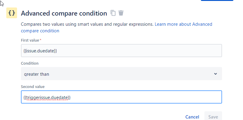

Inside the branch you can use the advanced compare condition like this:
Change 'duedate' for the fieldname you have, e.g. {{issue.End date}}
