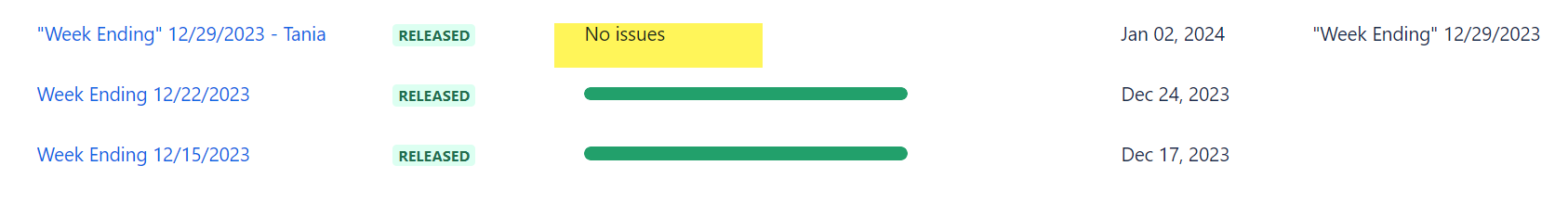

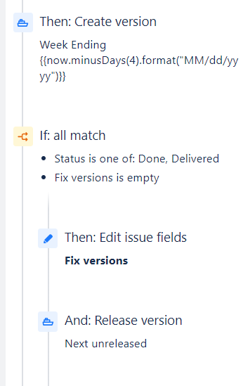

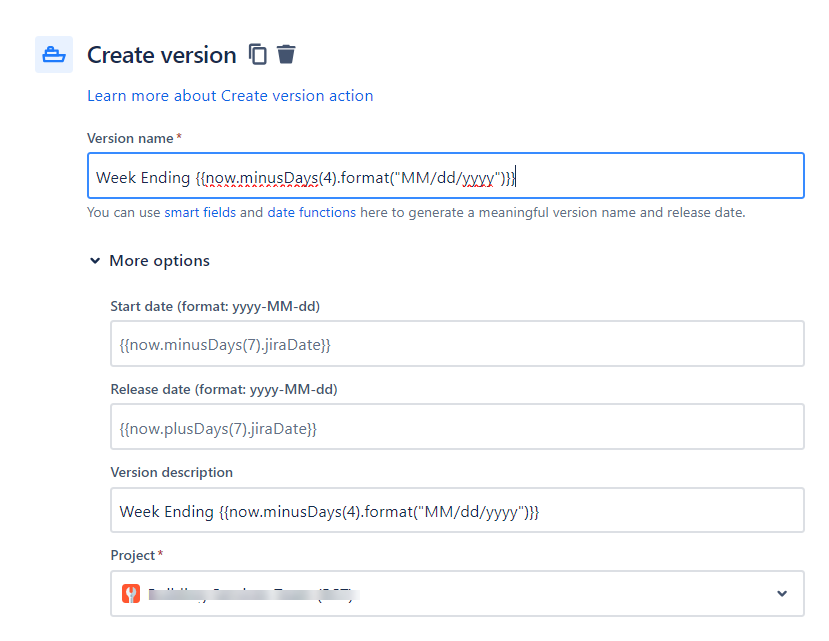

I have an automation that creates a version, edits the Fix Version field and releases the version but what is happening is one version is created and it is empty after the automation completes.  Audit Log shows that issues were found for the create & edit portion.  Once it's released, the issues are gone.

In automation, when you want to edit a set of issues, it is best to start a branch in your rule to define those issues and then add the exact actions into that branch.
Since your screenshot is missing the beginning of your automation rule, it's hard to determine how you are triggering it and how you determine the set of issues to edit.
After the create version part, I would expect a branch to start: For .. - you can use a JQL branch to specify the issues you want to edit:
fixversion IS EMPTY AND Status in (Done, Delivered)
And then add the edit action to fill out the fix version into that section of the rule.

Can you show us the complete automation rule? There are steps before the Create Version step that we need to see.
I think the problem relates to the context in which the Edit Issue and Release Version steps are running, but I need to see the rest of the rule to confirm.

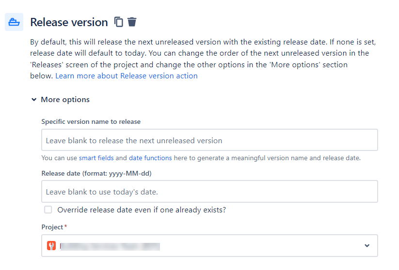

The Edit Issue action needs to be executed in a context such that each issue is accessed and edited.
The Release Version action needs to be executed in a slightly different context so that the action is executed just once after all the issues have been edited.
With the portion of the rule you are showing, I don't think you have structured the rule correctly to do that.

With a Schedule trigger that includes a JQL, each action in the rule after the trigger will be attempted for each issue returned by the JQL. In that case for each of the 1..n issues returned by the JQL, your rule is trying to execute both the Edit Issue and Release Version actions.
In this case I would recommend removing the JQL from the trigger and instead use a Branch (For Related Issues / JQL ) to retrieve and edit the issues, and move the Release Versions action outside of the branch.

Thank you Trudy.  I didn't catch that the release version was inside the if statement and have moved it out.  When I executed this previously, a version was created as Unreleased with all the issues in it so it appears the JQL from the trigger worked fine for that portion of the automation so unsure why I would need to do a branch and JQL instead.
The release version is supposed to find (by default) the most recent Unreleased version and release it and this should be the version just created.  I will try this now that the release has been moved out of the loop and if that does not resolve my problem, I will move the JQL out of the trigger and do a branch as both you and Walter suggested.

In your scenario you have a Condition to check that all issues match specified criteria. That Condition is being applied to each issue found by the Trigger JQL. It is not applying the Condition to all the issues as a group.
But, in fact, I don't think you need that Condition at all. You should be able to include those criteria in the JQL in the trigger itself to ensure that the set of issues you select are only those where both those conditions apply.

@Trudy P Claspill - The automation ran over the weekend to capture tickets and it created the versions, edited the tickets, released the versions (in separate automation) but when it released them, no tickets are actually in the release once again.  I even manually ran again after moving the Releases inside the main automation as you suggested to see if that was the issue and same results.  The audit log looks like everything is good but the Fix Version value seems to get wiped out after successful editing.

You appear to have three separate actions creating three separate versions with the same name. Why is that? Or am I missing some detail from those actions?

@Bill Sheboy  Thank you and your explanation is most enlightening about branches!  Your #1 suggestion is what I tried the first time and it still created empty releases with no issues.  I had the above automation kick off at 10:00 PM to create 3 versions in 3 separate projects, then ran the JQL to pull in the issues for all 3 projects and edit them.  Then at 11:00 PM automations kicked off to release each one (blank to pick up the most recently created version in that project.
@Trudy P Claspill Thank you as well for your persistence here, above explains that I am creating 3 versions for 3 separate projects at same time to get a team's entire set of issues for release since they span 3 projects, edit the issues and release the versions.
