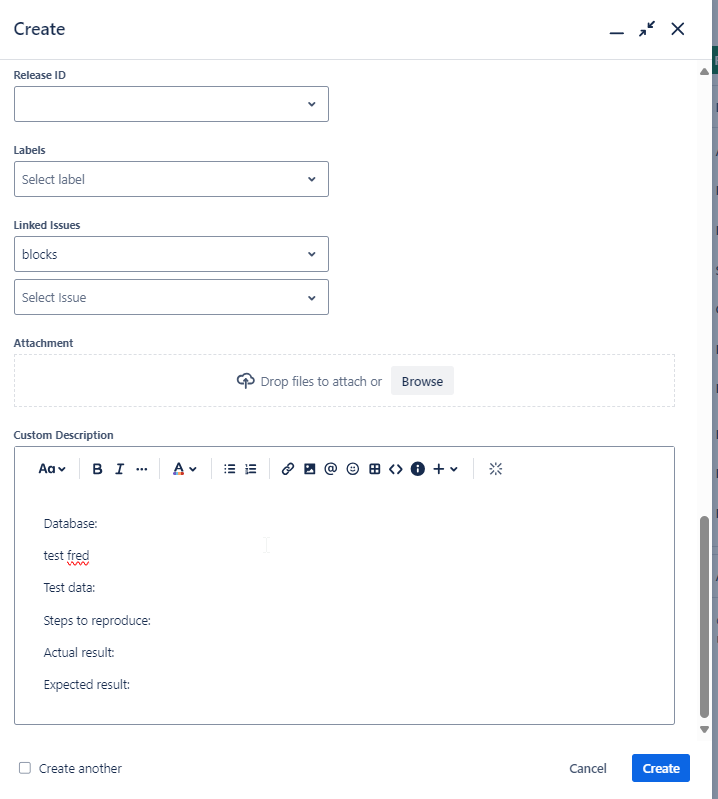

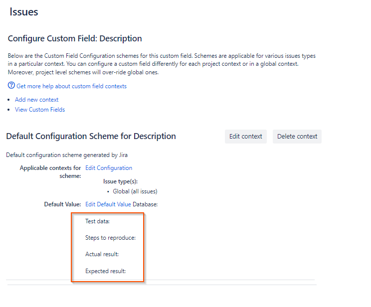

I've added a custom field 'Description' with predefined text:
Q1: In team based projects I was able to make this predefined text 'bold'. In company based projects it seems not possible?

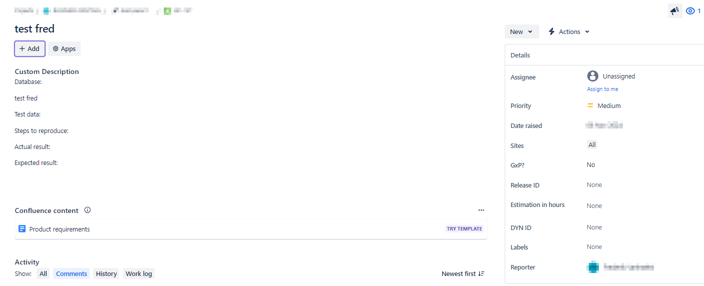

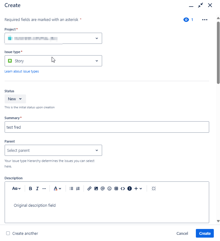

Q2: How I can get rid of the original Description field in the Create Dialog Box and replace it by my custom field 'Description'? Via Project settings > Issues > Layout I can remove the original one and replace it by the customized one but that's only on the issue page itself, not in the Create dialogue box:
On the issue page itself I have configured that I see only the customized Description field. How to configure this also in the Create dialog box?

Q2: You must update the Screen used for the Create Issue operation. That can be done only by a Jira Administrator.
