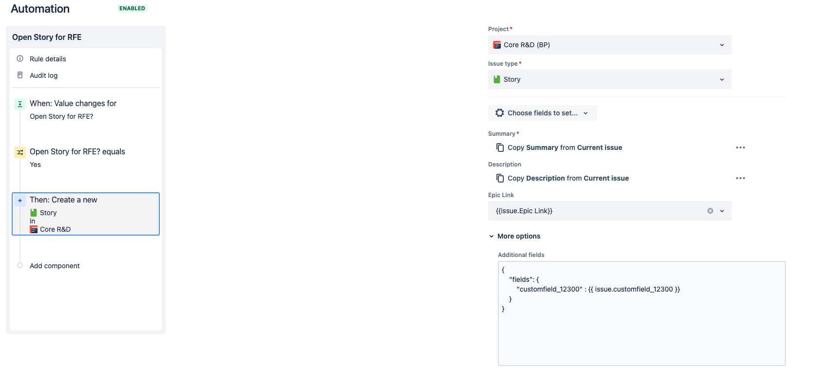

I would like to create an automation that once specific field is changed to Yes a new Story is created and the mandatory fields which are Epic Link and Team are copied from the triggered issue. I've succeeded with the Epic link but Team field is not found and I need to add a Json, I've tried few options but nothing works. Can someone please advise how the Json should look like? The example below is not working I'm getting the following: Error while parsing additional fields. Not valid JSON.
I've also tried  and it failed:
"fields": {
"customfield_12300" : issue.customfield_12300
But when I gave a specific team number it worked :
"fields": {
"customfield_12300": "39"

Hi @Sari Kachorovsky
You found the resolution yourself.
This needs to happen via JSON and you need to specify the ID of the Team

@Marc - Devoteam MY solution is not good, I don't know what will be the team, I need it to copy it from the triggered issue (The RFE). The teams can be different.
This will do the trick I think.
  1. Before creating an issue add the action: Re-fetch issue data
  2. Then add the action: Create Variable
  3. Then create the issue and use the json
You are missing a } at creating the variable.
The right input is:
{{issue.customfield_10001.id}}
Make sure that the Team field in you instance has the id 10001. I think it will as I think this is the default id value for field team.

@Marc - Devoteam opps u r right - I fixed it -but still getting the same error. I've tried also with customfield 12300 (cause it works for me for team in another automation) but still the same error.image.pngimage.png
I see you team field has the ID: customfield_12300 from your original post and there is an error in the json
You missed the closing quote " after "{{team}}
I think your json should look like this:
"fields":
"customfield_12300": "{{team}}"

@Marc - Devoteam It's working!!! Thank you so much for your help!
