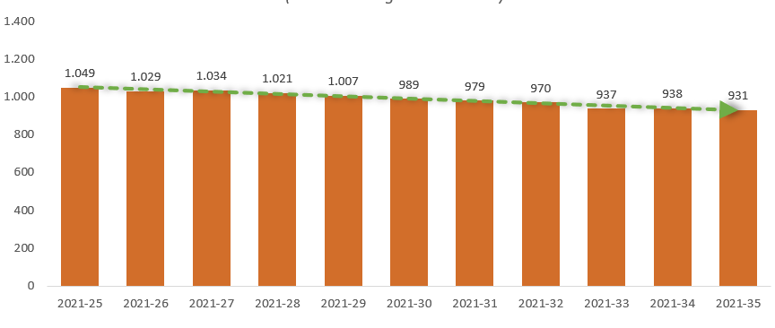

I can retrieve the amount of tickets that were open at the end of each week using the JQL query of e.g.
Project = Y AND status was in ("Open", "In Progress") ON startOfWeek()
Project = Y AND status was in ("Open", "In Progress") ON startOfWeek(-1)
Project = Y AND status was in ("Open", "In Progress") ON startOfWeek(-2) etc.
Any way to show this in a graph on a Jira Dashboard? Or another way to do it instead of above formulas?
Preferably using a bar chart e.g:
