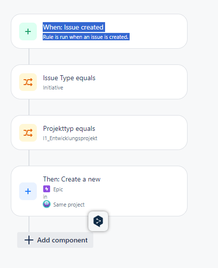

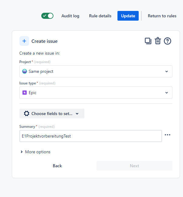

getting the above mentioned error by creating Epics in an automation rule. Setting up an Initiative firing a custom field "Projecttype" the rule should create the Epic (and underneath later Stories and tasks).
Here is the rule:
It's confusing, because the the rules went super before. Many thanks for any help!

Hi Olaf,
Without using an automation, check to see if there are any fields you must fill out to create a new Epic in your l1_Entwicklungsprojekt project when creating an Epic manually via [Create] Jira button.
If there are any required fields, those fields must also be filled out when creating a new Epic via automation.
When this mismatch happens you'll see Error creating issue Bad Request (400) as an error in your automation audit log.
Can you try to manually create the epic with the summary only?
Hi,
Can you make sure that the Epic issue type is still in the project ? Can you share the audit log of the rule please.
