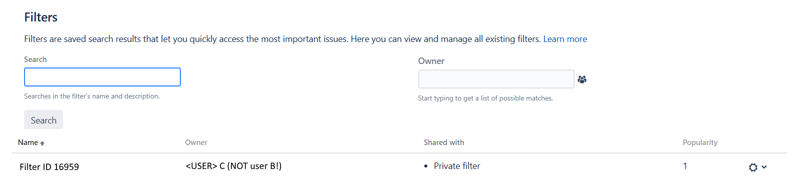

BUT: the Jira UI lists the same filter A with an owner of C! (confirmed by matching filter ID, filter name, and JQL)

just added my examples. :)
Let's say the user key in the filter is "rdostal". (😉)
The UI shows it as "jschumann".
So it's not even remotely close.
