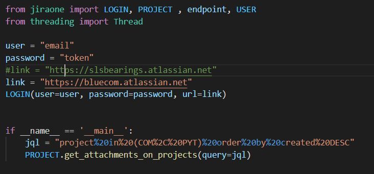

Yes, it's the same code. Please see the below screenshot.
I am trying to transfer attachments from bluecom to slsbearings.
Manually importing CSV doesn't show the attachment files. then, I tried this code.
Hi @susu.san
I think on your device there might be something wrong with the Threading, I'm not so sure what it is based on the response you showed. So I think a better way for you to do this is to use this script instead. It has a config.ini file which you will need to add your login credentials there. Since this is a cloud-to-cloud transfer, add the same credential for the source and target section. Then add your JQL query on the script on line 36 as mentioned on the README file.
