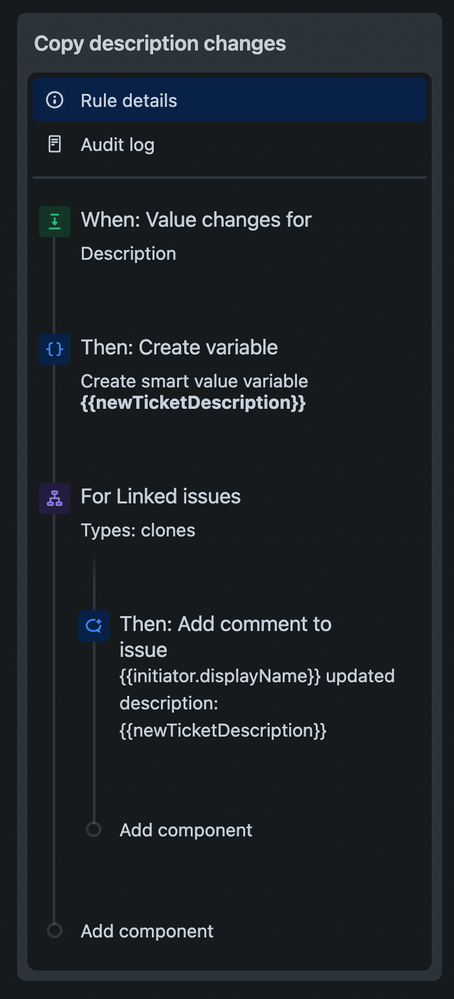

I'm busy setting up some automation rules to post comments to a parent if changes are made to the child's description.
It works as intended, but it posts the description before the change is saved, and not the new value. How would I go about posting the new value, and not the old value?
I've also tried {{issue.description}}. Any suggestions would be appreciated

Gerdi Olivier
April 5, 2023
For Linked Issue switches contexts the other ticket, so when it comments with a description, it will use the other ticket's description.
The solution would be to put the new description in a variable before switching contexts.
See screenshot in reply to Juan's comment
Bill Sheboy
April 5, 2023
Hi @Gerdi Olivier
If I understand your scenario correctly, you need to use the {{triggerIssue}} as the source of data to update the linked issues.
The meaning of {{issue}} can change in a rule based on the rule structure.  For example:
  • trigger: some action  At this point, {{issue}} and {{triggerIssue}} refer to the same thing.
  • action: some action  At this point, {{issue}} and {{triggerIssue}} refer to the same thing.
  • branch: to some issues  At this point, {{issue}} and {{triggerIssue}} refer to the same thing.
    • action: another action  At this point, {{issue}} refers to the issue(s) branched-to and {{triggerIssue}} remains the original one.
  • action: one more action  At this point, {{issue}} and {{triggerIssue}} refer to the same thing.
And so for your scenario, you could the Comment action to just use {{triggerIssue.description}}

Juan Carlos Vera
April 5, 2023
Hi @Gerdi Olivier ,
Try to put a "refresh" in the Automation,  Before the "FOR"
Hope it help you ;)
Gerdi Olivier
April 5, 2023
Hey @Juan Carlos Vera
Thanks for the suggestion, it pointed me towards the actual issue.
So because the context was switched back to the parent ticket (with For Linked Issue), it posted the parent ticket's description instead of the child.
This can be solved by first populating a variable before switching contexts.
Screenshot of working solution below:SCR-20230405-i5o.png
