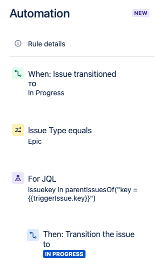

If I understand your request correctly, the key here is, that you need to use JQL in the automation to find the correct Parent issue to transition.  The key here is the JQL function:
issuekey in parentIssuesOf("ABC-123")
You can find additional information in a similar request:
https://community.atlassian.com/t5/Advanced-Roadmaps-questions/JQL-to-get-details-of-linked-parent-initiatives/qaq-p/1295379
In a Jira Automation rule, you need to create a branch based on JQL. The Automation could look similar to the picture below:
In your case, the JQL needs to be more specific to also search for the specific issue type (AND issuetype = XYZ). Please test the JQL before using it in Automation.
I hope that helps with your request.

Thanks for the post. The challenge is that we can't update the status of a parent issue which its parent is in another Jira project. This is the case in the screen shot that I sent.
However, for issue types that in the same Jira project, I used a simpler workflow that worked as below.

Just want to point out, that the branch you used (Epic (parent)) is only transitioning Epics not the parent Objects above the Epic.

I see. Is there a way to update the parent object above the Epic? I don't think so.
Mathias Richter
September 15, 2022
You should be able to update the parent issue using the Automation I provided on 11-Aug. This requires ScriptRunner installed in your environment.
If you have that, the JQL I provided should work and return the current parent of the epic
