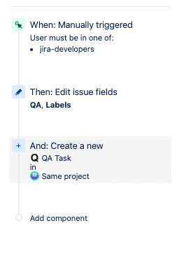

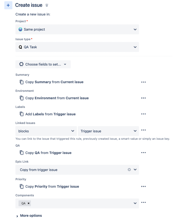

For the QA task to be a child issue, you need it to be a subtask issue type. In the example below I have created a QA issue type that is a subtask:
You can then create QA subtasks through Automation:
Depending on your configuration, you may also not want to create a dedicated subtask for QA tasks and just use classic subtasks:

I suggest not to copy the epic link fron the story so that the QA Task will not show up in the epic view as child issues.
The QA Task are need to be linked to the stories. You can have them on the same board as stories or created a decidated board for the QA team.
The other solution is to create a issue-type QA task but as a sub-task. So that QA tasks will show under stories as sub-tasks.
