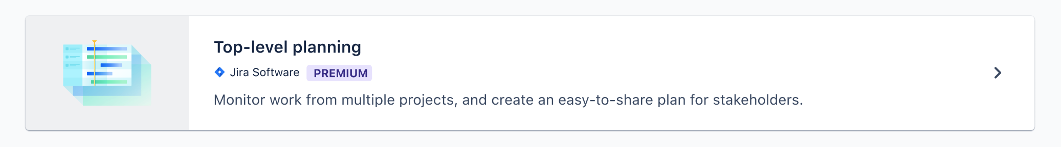

Where is this new template?
If you’d rather just explore it yourself, here’s how to find this new feature in Jira Software Premium:
  1. From anywhere in Jira Software, select Projects > Create project from the top menu.
  2. In the Software development tab on the left (which is the default tab), select the Top-level planning template.

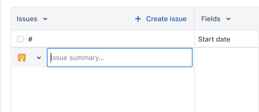

  1. To start, create your first Initiative.Screenshot 2023-07-07 at 11.05.46 AM.png
    Think of an initiative as a piece of work that multiple Epics contribute; for example, if your Epics are things like “Build New functionality”, “Market new features”, and “Measure impact of release”, then your Initiative might be something like “iOS Design Revamp”. You only need to create one right now; you can always add more later. Learn more about Initiatives.
