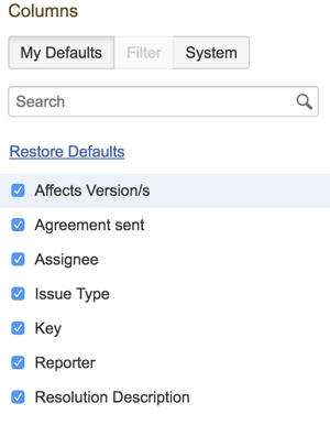

Now about those large filters! Have you ever had a bulk change with a lot of issues time out on you? Had to try the bulk change again with smaller amounts of issues? That read timeout is actually coming to your assistance here! Take a look at the search you're starting with, and see what columns are selected in List view:
The more columns that are selected, the more work Jira has to do during a bulk change to render all the items in those columns up to the max number of issues - maybe 1,000! If you're about to do a bulk change, save yourself some headache and uncheck everything except the Key, Issue Type, and Summary. You'll be amazed at how much faster the bulk change screens load, and you won't encounter issues with a timeout.
