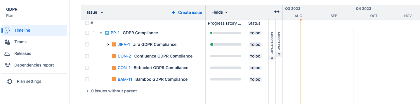

Imagine this fictitious, but realistic example (Please Note - the following examples and screenshots are of fake projects and plans created to illustrate the problem. I used GDPR as an example of a previous project that would be understandable as a cross-cutting concern).
Atlassian needs to support GDPR across it’s portfolio of products. This is what the plan looks like:
At first glance it appears that the project has not yet started. There are no dates on the roadmap and all the issues are still in the "TO DO" status.
However, the progress bars for "PP-1" and "JIRA-1" are suggesting that some work within the hierarchy has already been completed.

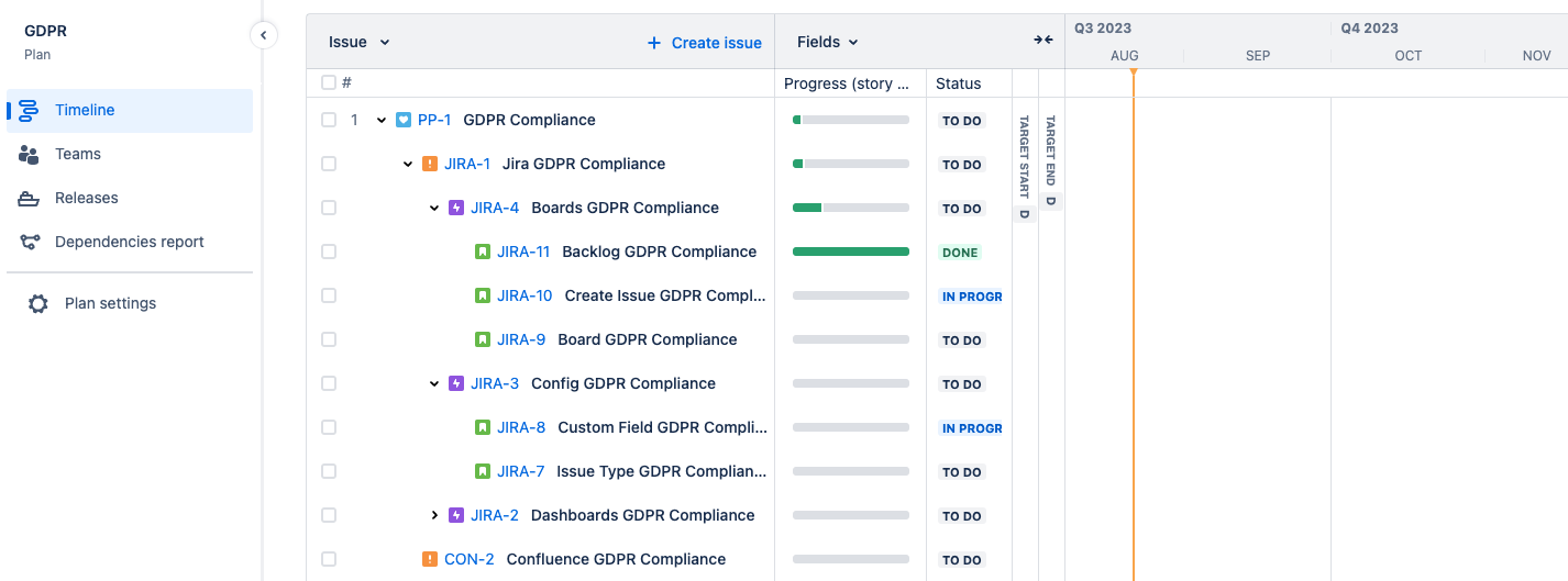

Expanding the initiatives and epics indeed reveals that some story level issues are
"IN PROGRESS" and another has already been "DONE". The engineers have not remembered to update the parent issues and dates are not appearing (this might be because the start and end dates cannot be inferred - perhaps because the team is using Kanban rather than Scrum!)

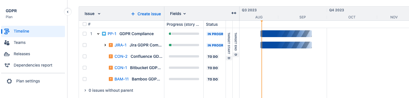

Before jumping into how I built the application, let’s look at what the output looks like with it running.
At a glance you can now see that Jira has started work and when the work was started (if not yet when the work is planned to complete). The information is readily available without needing to expand all of the issues that descend from the initiative level issues.

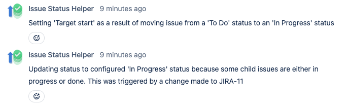

Comments are also added to an issue when it is changed to help reporters, assignees and watchers understand what is happening.

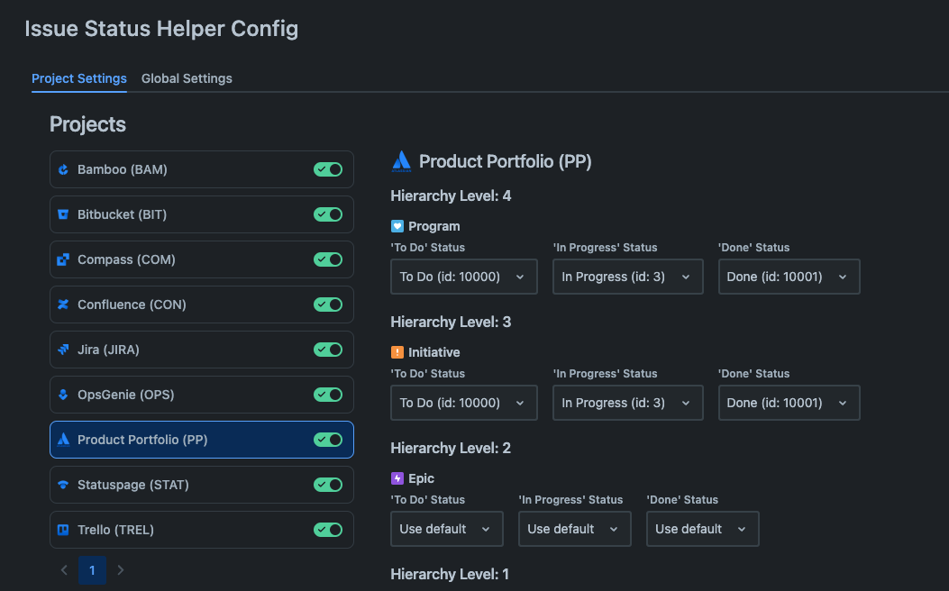

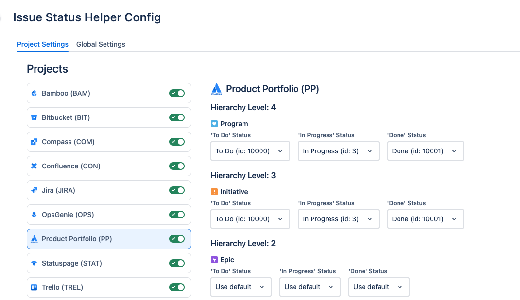

The configuration page looks like this:
The interface for the application configuration is entirely built from Design System components and heavily leans on the new “primitives” (which at the time of writing are in Open Beta - but when you read this might be generally available!).
Using these primitives enabled me to quickly build a complex layout without needing to write any custom styles. Everything was created using a combination of the Box, Inline, Stack and Grid primitives and uses space token values to ensure consistency the Jira
Building the interface with Design System components meant that the application immediately supported dark mode with close to zero effort:
