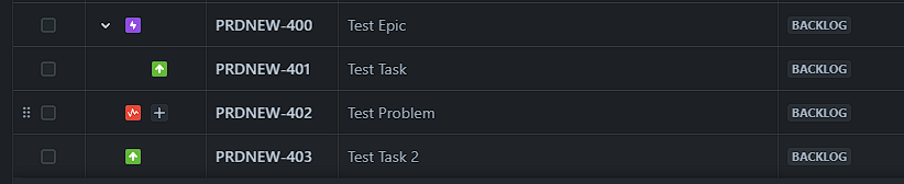

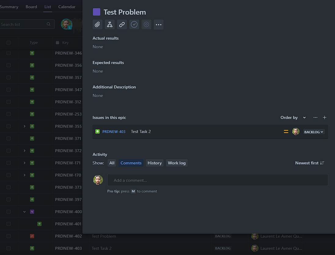

For instance, I've created an issue type called "Problem", in the same hierarchy level of Epics, and tried to link standard issue types to it through the "Parent Link" field.
For Epics, I can even create new standard issue types below it directly from the List view, but the same doesn't happen for the "Problem" issue type I've created.
In the screenshots below, I was expecting that the "Test Task 2" would be nested in "Test Problem", just as the "Test Task" is nested in the "Test Epic".
