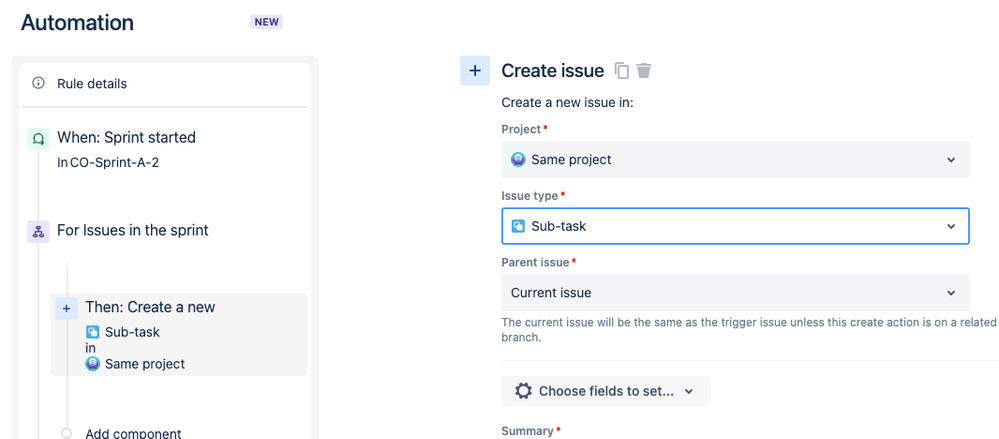

There is a rule Trigger for Sprint Started.
You could use that and follow it with a For Branch/Related Issues to retrieve all the issues in the sprint under which you want to create the subtask. You can use either the Issues In Sprint option if you want a subtask created under every issue in the sprint, or the JQL option if you want the subtask created under a subset of issues in the sprint.
Then add the Create Issue action to create the subtask.

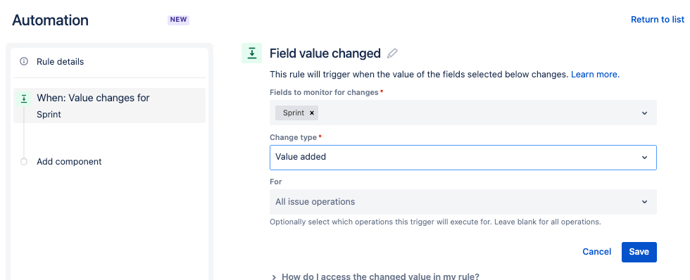

The problem with Automation 1 is that you are triggering it based on a change to the Sprint field. So, yes, when you add an issue to a future sprint the Sprint field will be updated and the rule will run.
That is the trickier situation for which I have not had time to work out the steps. I think it might work if you add a condition to check if the issue matches JQL. First make sure that the trigger is happening only when the Sprint field gets a value added (so it won't be triggered if you remove an issue from a sprint).
With this condition it will be confirmed that the trigger issue is in an Active sprint. If the issue was already in an Active Sprint you would not be able to also add it to a Future Sprint, since issues can be in only one Active or Future sprint at a time. And you can't add an issue to a Closed sprint. So this should catch an issue being added to an Active sprint, I believe.
