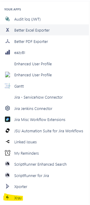

Good day!
I believe, your question is for Jira cloud. Please correct me if it is not.
If its Jira cloud, you can simply go to Apps on the top navigator -> Xray -> Configure project
Also, you can find the Xray settings in the individual project. Navigate to Project setting -> Apps -> Xray settings.

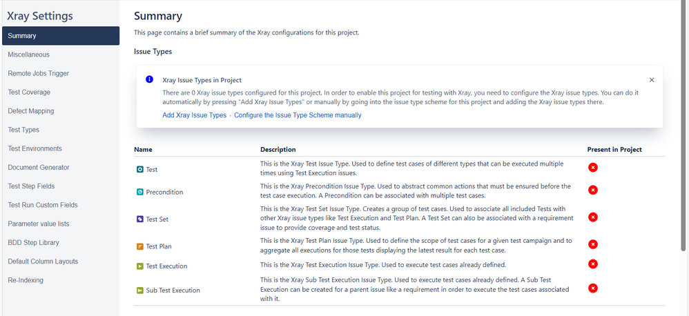

No i get gives me the warning " Manual Configuration required " on Issue type mapping instead of "Add Xray Issue types" manually
When you navigate to Xray settings - You will have 2 options "Add Xray Issue types" and "Configure the issue type scheme Manually". You can choose either of these options.
When you choose "Configure the issue type scheme Manually" - You will be navigating to the Issue type scheme page - there you can choose "Edit Issue type" and simply drag & drop the Xray related issue types.

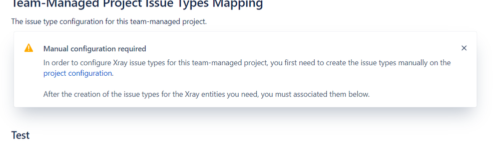

I am not getting both of the options above instead I am getting this and I do not want to confgure manually
I can see that you are trying to enable Xray for Team managed project.
Please refer this link on how to configure the xray issue types - https://docs.getxray.app/display/XRAYCLOUD/Project+Settings%3A+Issue+Types+Mapping
