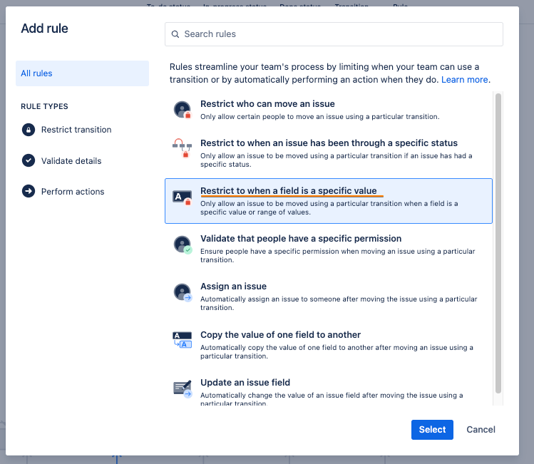

Sorry, haven't noticed you are working on a Team-managed project. In this case the flow will be slightly different:
1. Click on the three dots in the right upper corner on the board
2. Select Manage workflow
3. Click on the transition that needs to be updated
4. Click on the "+" for the Rules on the right side
5. Select the following from the Rule list: Restrict to when the field is a specific value
6. Select the field you need and configure the remaining values
7. Click Save
8. Update the workflow

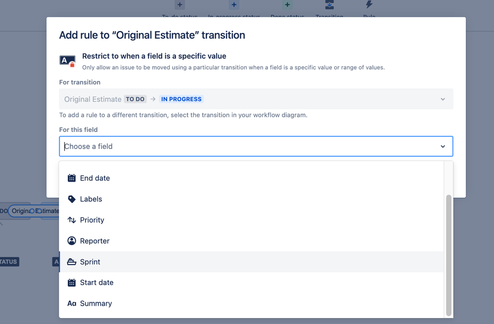

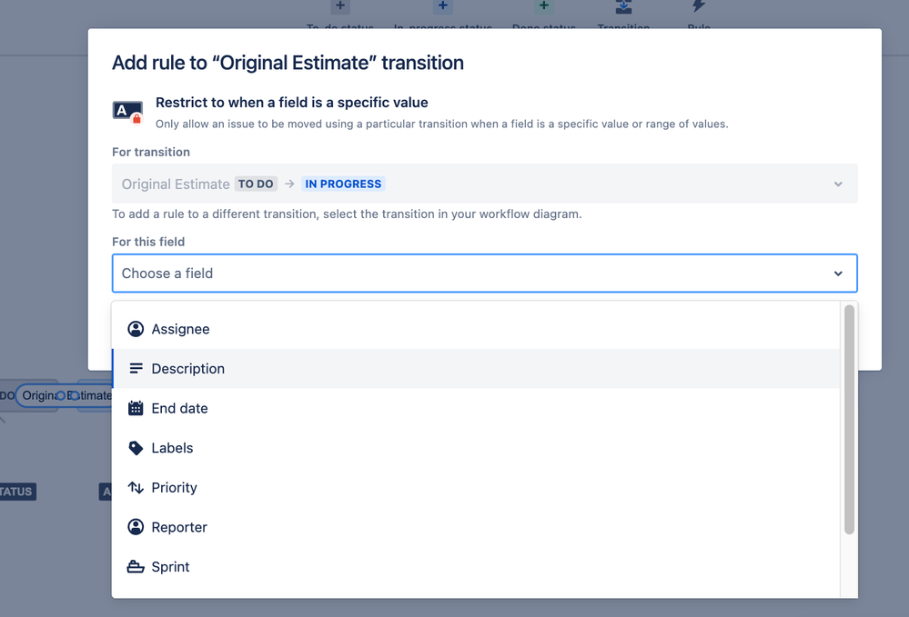

Hello @Oleksandr Siryi_Railsware_ and @Trudy Claspill ,
Thank you very much for the suggestions.
I don't have the option to select the field for Original Estimate. You can see below the available fields for me. Can you please advise on what is the reason for this?
And to your question @Trudy Claspill, I would like to confirm that some work has been logged against the issue at some point prior to attempting the transition.

You can use the "Restrict (transition) to when a field has a specific value", as suggested by @Oleksandr Siryi_Railsware_ , for checking that the Original Estimate field is not empty.
Regarding requiring the Work Log, are you trying to (1) require the users to log work as part of the transition, or do you simply want to (2) confirm that some work has been logged against the issue at some point prior to attempting the transition?
(1) is not possible in Team Managed projects because they do not support adding a Screen during the transition to force entry of data while the transition is occuring.
(2) is possible by checking the Time Spent field in the same way you can check the Original Estimate field.

Hello @Gergana Boeva
I apologize. I spoke without first validating my suggestion.
It does appear that neither the Original Estimate nor the Time Spent field is available for selection in that workflow transition rule in Team Managed projects.
I have not yet found any documentation or change request that specifies what system and custom fields are available, but I am continuing to look.
Given that you are on a Standard plan, you could also reach out to Atlassian Support directly to see if they can find and provide that information more quickly.
