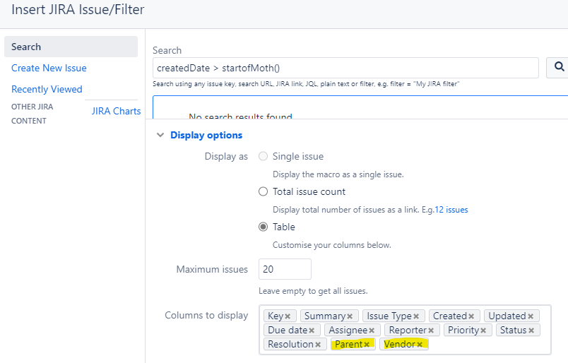

Have you included the wanted fields in Display options? Only the 11 fields you see in the image below are shown by default. You can add more fields by selecting them from the dropdown.
The image below shows that I have added two more fields, Parent and Vendor. Ref yellow markings. Now these fields will also be shown in the macro result.
