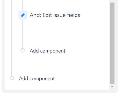

thank you so much for your proposal. I don't know if it is a good approach, but meanwhile I managed the following:
I lookup in Assets where my values to compare with are:
With that I can compare the ID of my issue (it is something like 11.0 hence the round) wiht the values from Assets. If the value is found I edit a custom field.
If not, I check in an else-if block, if it is another value. If the value is found, I edit a custom field.
If none of the above matches, I edit the custom field in a last Else block to a certain value.
That works so far!

with your help, I think I could fiddle out a solution for my use-case 🥳
First, I want to share some findings with you.
It seems, my "Request Type ID" custom field is configured as number, is it usually like that or how is it configured then?
As I used your suggestion from above {{issue.Request Type.requestType.Id}}, this gives me an integer-like value. I guess, you meant that initially in this thread, instead of a custom field "Request Type ID" of any kind?
Some automations fill and update that custom field, which explains the delay in the automation, which it is about in this thread.
The solution that works for our use-case looks as follows:
The trick is the first step to put the value from {{issue.Request Type.requestType.Id}} in the custom field "Request Type ID" and refetch data. With this I do not run into the timing problem. From then on, I can work as desired with the (integer?) value for the comparisons and updating the other custom field.
Thanks a lot @Tessa Tuteleers for your kind and patient support.
