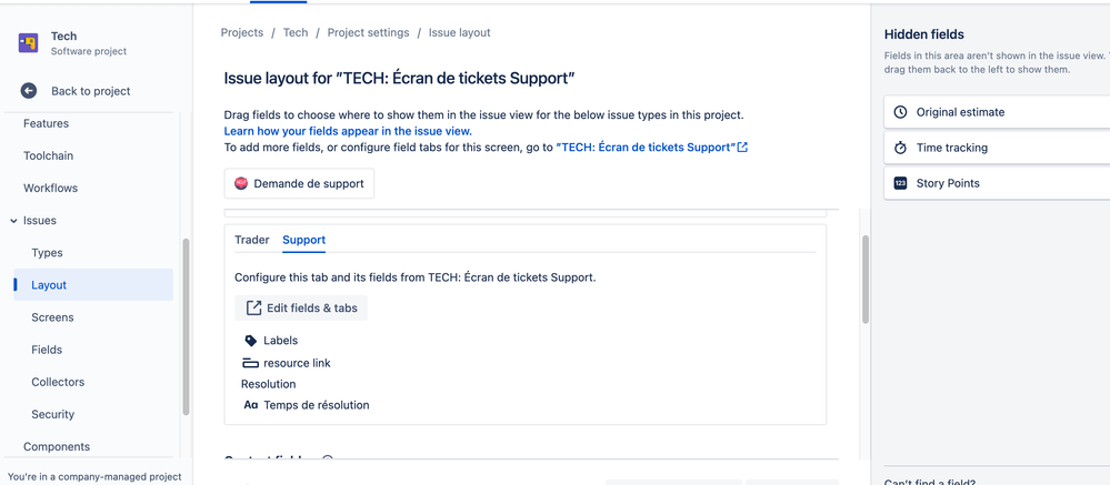

I have checked the issue layout of this ticket, and it does appear:
To be noted that I tried something else just in case: I changed the issue screen of this issue type by putting the "Resolution" field in the first tab instead. In this case, the "Resolution" field would not appear at all in the issue layout configuration panel.

Resolution field, but also other fields as well placed inside a screen, are visible when populated. However, resolution is a systemic field which you can't simply edit. Consider it as a very special field. Resolution appears next to the status, when and if populated:
