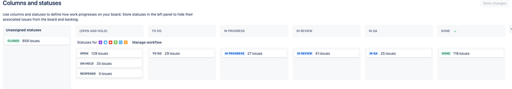

Can you show us a screen image of your Columns And Statuses page? Is the Open status mapped to a column or is it in the Unmapped Statuses area on the left? Each status must be mapped to a column for issues in that status to show up on the board and in the Backlog screen when you have the Sprints option turned on.

1. Backlog does not show OPEN/ON HOLD/REOPENED when columns are as below. Note that Sprint shows OPEN/ON HOLD/REOPENED.
2. Both backlog and sprint show OPEN/ON HOLD/REOPENED when columns are as below.
In summary, the only difference is the order of columns. The more weird thing is why the behavior between backlog and sprint of Backlog (scrum) is different.

When you are using a Scrum board Jira expects that the items in the column farthest to the right on your board will be mapped to the statuses used to indicate work on the issue is completed. It doesn't matter what the Statuses in the column actually are. Jira will consider issues in the column "completed" and will not display them in the Backlog list.
When you had your Columns and Statuses set up with Open, On Hold, and Reopened in the column farthest to the right, all issues in those statuses were considered "complete" by Jira, and therefore were not shown in the Backlog.
When you changed the mapping so that the column farthest to the right contained only the Done status, then only the issues in the Done status would be considered complete. At that point, issues in the Done status would no longer be shown in the Backlog list. Open, On Hold, and Reopened were no longer in the column farthest to the right, and so Jira no longer considered issues in those statuses to be complete, and would again display issues in those statuses in the Backlog list.
