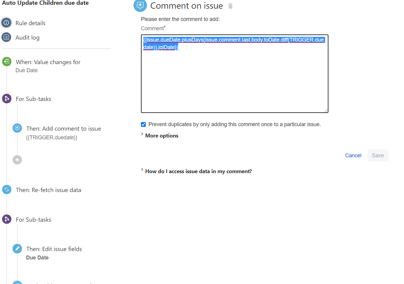

Is there any way to have a smart value get information from the parent. I want to have the child get the parents due date using smart values. I know you can set it to reflect the parents due date but i need it in smart values so i can calculate a difference
EX of what i have now:{{issue.dueDate.plusDays(issue.comment.last.body.toDate.diff(TRIGGER.duedate)).jqlDate}}

Can you give more details on the expected flow of your rule?  If the parent is the thing triggering, you can use {{triggerissue.duedate}}
If you are triggering from a child changing, moving up to the parent, and then back down to the sibling children, you might need two rules because you cannot nest branching...
Or to do in in one rule:
  • Trigger on child,
  • Branch to parent to get their duedate and save it in triggering child,
  • Re-fetch the triggering child, and
  • Branch on JQL over the sibling children to update them.

Thank you for responding. Im trying to make it that when a parents due date changes the children's due date change by that same amount.
So my thought process was to save the parents current due date as a comment, then re fetch the issue data, then make the children change their due date by referencing that comment and the parents current due date.

Hi, and thanks for clarifying. So...
  • When the Parent Due Date changes...
  • Check if an existing comment exists, you calculate the difference, in order to...
  • Update the children's Due Dates by that difference amount
  • And save the latest Parent Due Date in a comment to refresh it
Correct?
First thing, I wouldn't use a comment for storing the value.  Instead consider adding a custom field of date/time type; maybe Last Due Date.  It will save problems of conversion.  Otherwise, your approach should work.
