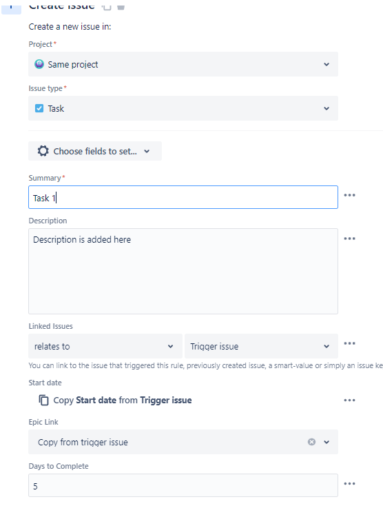

Here is Task 1 in detail. This is working, because I can reference the trigger issue for the start date:

@Eric Younkin I don't see in the Automation where you are setting the Due Date for Task 1. Are you setting its Due Date in this same automation rule?
If the Due Date field on the Task 1 is not getting set, then that would explain why the Start Date for Task 2 has no value.
Like Bill Sheboy likes this
Eric Younkin
April 18, 2023
@Trudy Claspill , YES!!! I didn't even think of that, but you are absolutely right. I was setting the due date with a separate automation used to keep tasks in line as they are worked. When I changed it to be part of this automation, that solved the problem!
Thanks so much for your help - I wish I would have thought of that sooner!
