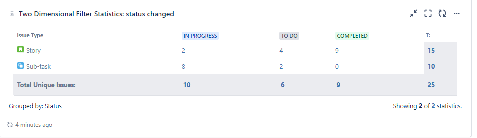

No. The 2D gadget I pasted in a previous comment, using the latest JQL I showed you, will show:
This mean that the above JQL can include changes to more that one status. E.g. I have an issue which yesterday transitioned from TODO, to In Progress and then to DONE. This will be seen in the gadget in the column DONE only one time.

Yeah it solves my query, but I am having hard time to understand how it works and how to read this report.
Can you post please a screenshot of your 2D filter gadget?
So, you tell your boss that:
Yesterday, 2 issues of type stories were transitioned to In Progress, 4 to ToDo and 9 to Completed. And 8 issues of type subtask were transitioned to In Progress and 2 to ToDo.
