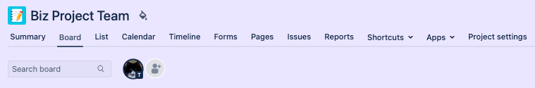

Are you working with a Software project, a Service project, or a Work Management project? If you have navigation options across the top of the screen like below, then it is a Work Management project.
If it is a Work Management project and issues are "disappearing" only from the right-most column, or only from columns that have green statuses mapped to them, then be advised that green/Done issues will be automatically hidden on the board when they have been in that status for 14 or more days.
If you are instead working with a Software or Service project, is the board a Kanban board or a Scrum board? Also is the project Team Managed or Company Managed? The latter will be displayed at the bottom of the navigation panel on the left. Done issues (right most column) on Kanban boards for Software and Service projects may also be automatically hidden based on how long they have been in that status.
If Done issues are being hidden automatically the issues should still be appearing when you select the Issues navigation option for all types of projects. If they were deleted, archived, or moved to another project then they would not appear in the Issues navigation option.
