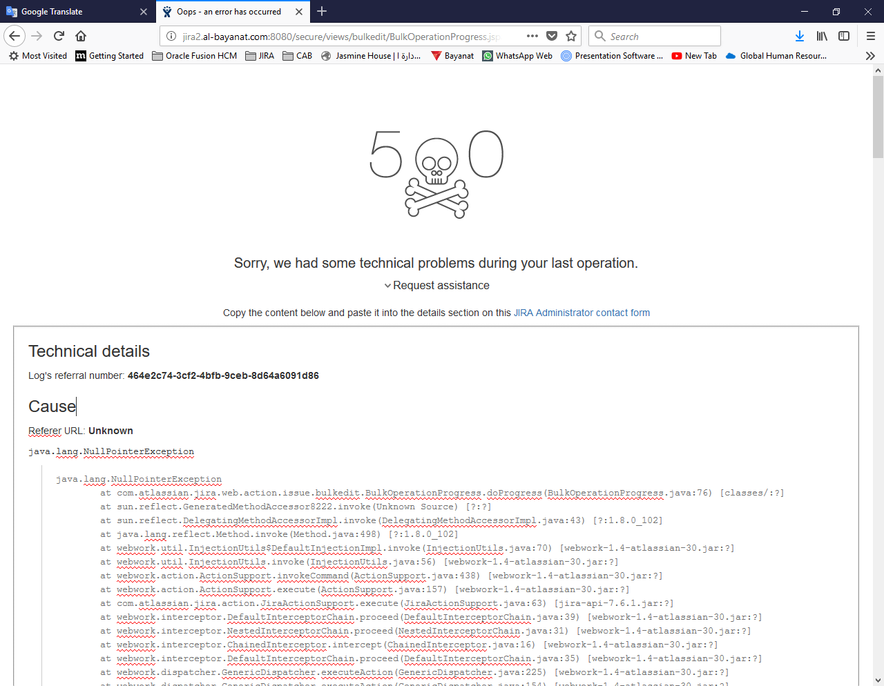

Dears,
please note that the following error problem that i have faced when i tried to delete a bulk of issues:
Log's referral number: 464e2c74-3cf2-4bfb-9ceb-8d64a6091d86
Referer URL: Unknown
java.lang.NullPointerException

There is not enough of the underlying error being shown there to begin to diagnose the problem.
You'll need to read the log(<jira home>/logs/atlassian-jira.log) in full to find out what has gone wrong - it should be easy to find the section you need by searching it for the first couple of lines of the detail error in the screenshot.
i know i have tried to attach the log here but unfortunately i couldn't,
You just need to read the section before and after that text. No-one here is likely to read your entire log for you, but we can't begin to guess at what the problem is without seeing all of the error you've posted.
i have referred back to the LOG, but i couldn't understand where is the error
