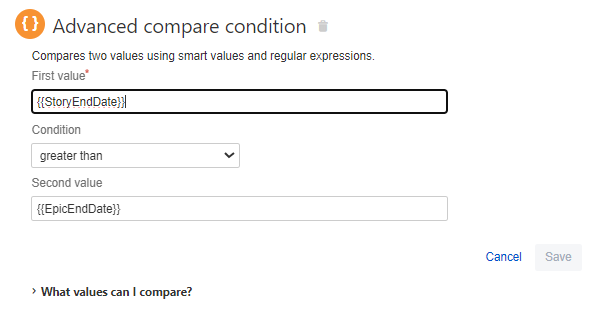

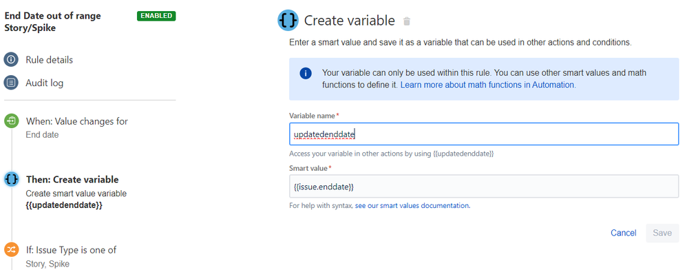

If a Story's End date is after the End date of the Epic defined in field "Epic link" then this shall be reported. In the request from my co-workers was have a list shown. I decided an Email should be send might be better. As can be seen in the example. Automation.PNGI created a SmartValue  and to be checked later within the Epic End Date. So the system is able to check those two dates with each other. I've tried "due date", I also have tried different spellings. Nothing has worked. SmartValue.PNG
As you can see on the last picture, from the audit log, it seems to be a success but it never sends out an Email. The provided issues are examples from myself to test this.

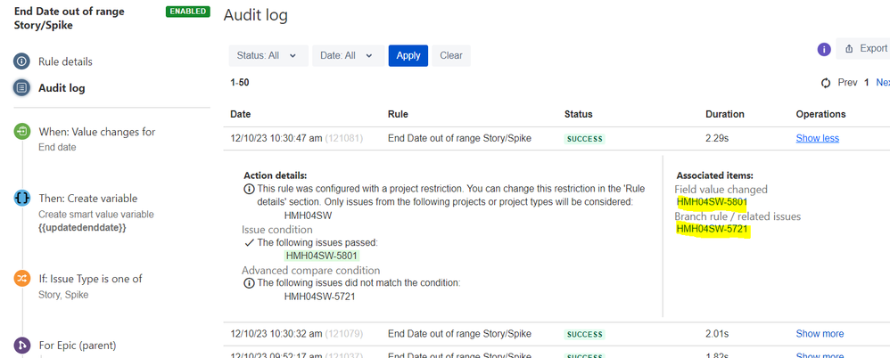

Thank you. yeah I actually tried the dev option on the website to use an Audit Log (like someone suggested. Can be seen here in the picture.
It shows later in the audit the correct changed End date! SO my next move would be to change Variable of the smart value which I circled in the extract. But that would mean I also have to change the advanced comparing of those two variables. In this pic:

Alright, sadly it still does not send out an email. I think it always stops at the last part. CustomField.PNG
As you can see I changed the comparing condition. And even made sure that we can see both end dates in the Log file (12.12.2023 Story &  05.11.02023 Epic)
But somehow it still did not send an Email. If you have an idea feel free to share it, but I would also understand if not. Because I have no idea what's wrong anymore.

It did sent out an email but weirdly did it in any of those cases. I had another look at it with a colleague and I will show how the exact solution looks like in case so. needs to create something similar. The problem is the system can not understand the comparison of the customer field ( you can see them in the extracts) as in parent and child what I did earlier. But by creating two Smart values for each particular field, it works.
Trigger : End date change of a Spike or Story.
Optional: Audit Log of Story EndDate {{issue.customfield_14803}} to be able to check in the Log if it is using the correct data
Creating Smart Value: This will be needed by the comparison later
Now change to the Epic element  and repeat.
Optional: Audit Log of Epic EndDate {{issue.customfield_14803}} to be able to check in the Log if it is using the correct data
