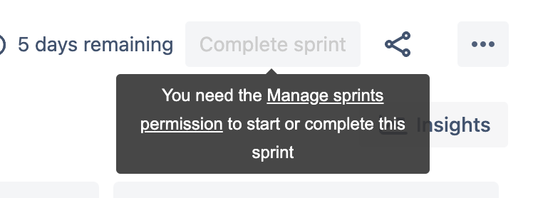

Yes, I do have permission to be a Sprint Manager, and able to create a new sprint but unfortunately still not been able to complete a sprint. I am not sure why, looks like i have granted with all necessary roles.
Ekaterina Berestovenko
April 19, 2023
That's what it's showing me, and I do have this permission Screen Shot 2023-04-19 at 2.15.41 PM.png

Thank you for the additional information.
There may be an issue assigned to your sprint that is actually in another project and outside the scope of your board's filter.
Please go to the Advanced Issue Search screen and execute a search for
sprint in <the name of the sprint you are trying to complete>
Two things to check:
1. When typing in the name of the sprint for your search, does Jira show you two matching sprints with identical names?
2. If not, review the results of the filter to see if there are any issues from a project other than DST that are included.
Jira does not prevent users from adding issues to sprints when the issues are not in the scope of the board filter where the sprint was created. When that happens, you won't see the rogue issue on your board in that sprint because the board's filter prevents it from displaying. But having that rogue issue in your sprint could block you from completing the sprint if you don't have the Manage Sprints permission in the rogue issue's project.
If this turns out to be the case, you may need to edit that rogue issue to remove it from your sprint. And you should also look into why it got added to your sprint. You can see who added it in the History of that issue. Jira does not prevent creation of sprints with identical names. Do you have sprints with identical names but from different boards in your system? That can cause confusion for users. You should implement a policy/process of ensuring sprint names are unique.
