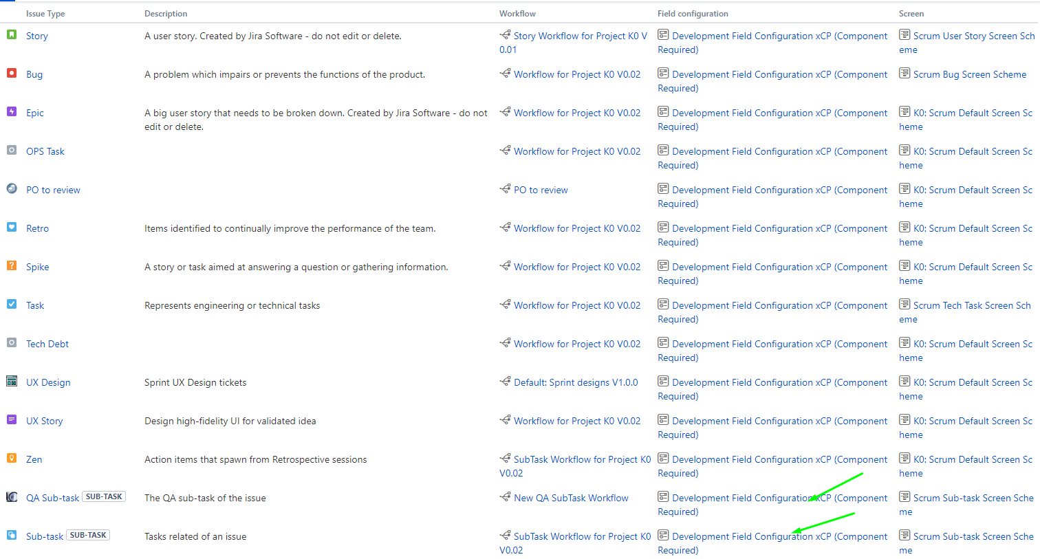

This screenshot is of a "field configuration scheme".  You've chopped off the "add" at the top right of it and the "change" options in the rightmost column, but those are what you need to use to add new field configurations or change the existing associations.

Sorry - this is the Issue Types page - I don't seem to have the options you mentioned.
If I "Use a different scheme" then it prompts to change the entire project.

Ah, ok, wrong place! Try going to the fields section and look for the field configuration and field configuration scheme
