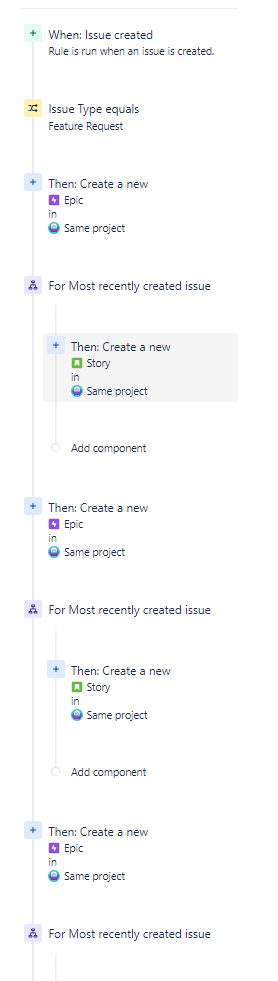

The trigger issue is the creation of an issue type called Initiative.
Upon creation of this issue type, I aim to create four epics and within each epic, four unique stories. Those stories must be a child issue of their respective epics. The problem I am having is I cannot find a way to link the story to the epic when it is under a branch. It is always linking back to the trigger issue (Initiative) or not at all.

I expect this is how you want the issues to be created
One thing I have changed is to connect the feature Issue with linked issues relation
Here I have created one feature two epic & two stories
Here is the Rule for your reference
And for Story
Let me know if you have any queries!!

Pramodh M
January 8, 2022
FYI
You need to replicate the Create New Epic Sections and Create New Story 4 times in order to create Issues 4 times

Hi @Richard Canlas
I checked it's working for 4 issues as well, you need to add the rule.
Here's the reference
Now when creating the Epic Issue rule is like this
And when creating a Story, first create a branching condition and then create an issueA4.png So the final rule should look like this

Richard Canlas
January 8, 2022
I realized what had happened and the Epic Link field disappeared from the first story for some reason when I was testing this, so I re-inserted it and voila! it worked. Thank you so much! I have another question related to automation but it's an entirely new idea that involves copying a field name from the trigger issue AND adding a new text into it in the same line, but I understand if I have to make a new community post for that.
