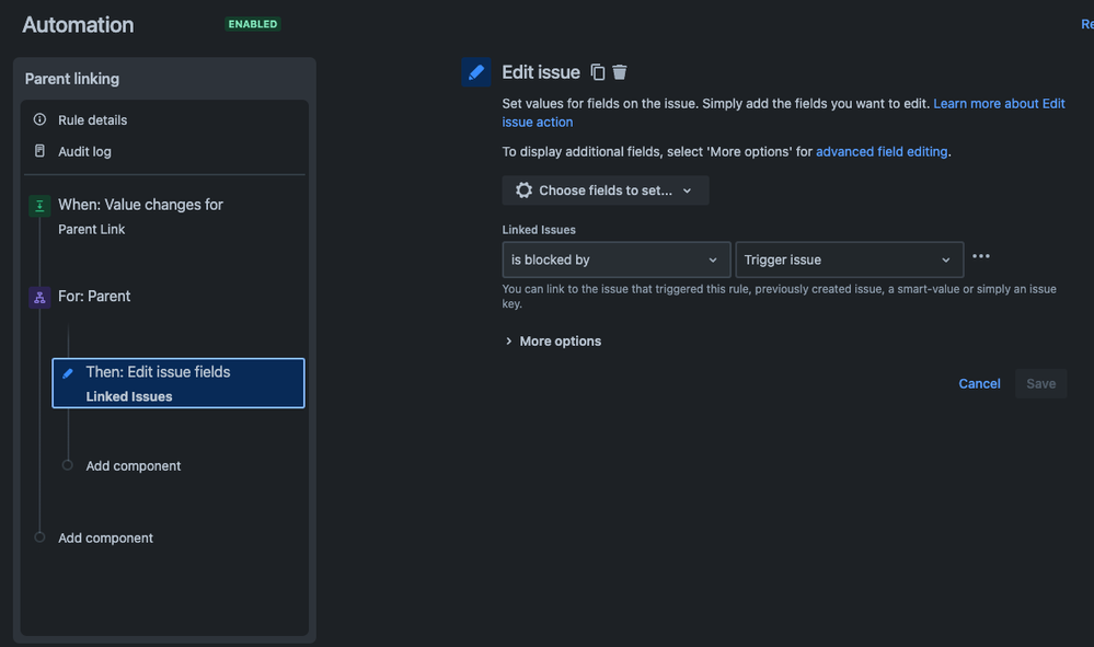

I've tried the following automation in Project A:
  • When: Value changes for Parent Link
  • For: Parent
  • Then: Edit issue files
    • Linked Issues
      • Is blocked by: Trigger issue
This does not create the link between the Epic and Initiative. I've added both of the projects as the Scope for the Automation.
Any thoughts on how to get the Automation working?
Thanks.

Janne Jääskä
September 19, 2023
Hi @Francis Batilo
Thanks for the quick reply. Here's screenshots for all of the automation rules I'm using + audit log.

Francis Batilo
September 20, 2023
@Janne Jääskä ,
Thanks for providing the screenshots. From what I've gathered, the Parent Branch feature is used for identifying the parent of a sub-task, and not the parent of custom hierarchy. The nomenclature is definitely not helpful, and I tried to it for the same purpose and found it not doing what I want.
I would suggest that you use JQL instead of the Parent Branch, check out the screenshots I have below. I've tested it and it works for what you are trying to achieve.
I hope this helps.
Cheers,
Francis
Like Janne Jääskä likes this
Janne Jääskä
September 20, 2023
@Francis Batilo ,
Big thanks for the solution. Works perfectly!
Best regards,
Janne
