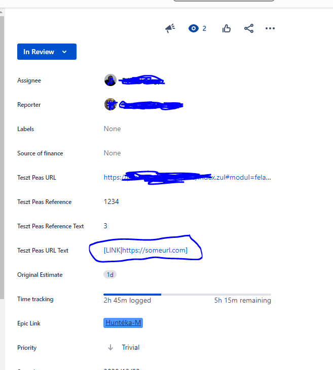

I have a URL typed customfield, and I have a very long URL, so I want to add an alias to it.
I cannot change the renderer for URL type customfield so, I created a Text Field and I changed the Renderer to Wiki Style Renderer.
The format that I tried: [LINK|https://someurl.com] but it isn't working that I expected.
I want to see in my customfield just a LINK label, which is a hyperlink, but I cannot manage to solve this problem with a text field and with an URL field too.
What am I doing wrong?

I triple checked it, and I use MultiLine Text field with Wiki Style Renderer, as the screenshot prove it.
Still works for 1 second, and after that, it will be plain text again.

There is bug in our cloud jira I think:
I just did what you recommended, and I typed both of the format solution into a multine text field:
When I press F5 in Chrome browser, it appers correctly in the second solution in multiline text customfield, but at the moment, that the page fully loaded, the formatting is gone again. Very strange, but I tested again and again.
So it is working for 1 sec, until the page fully loaded.

Using
the perfect link appears for a second then comes back to a non-clickable [LINK|https://someurl.com] at all
