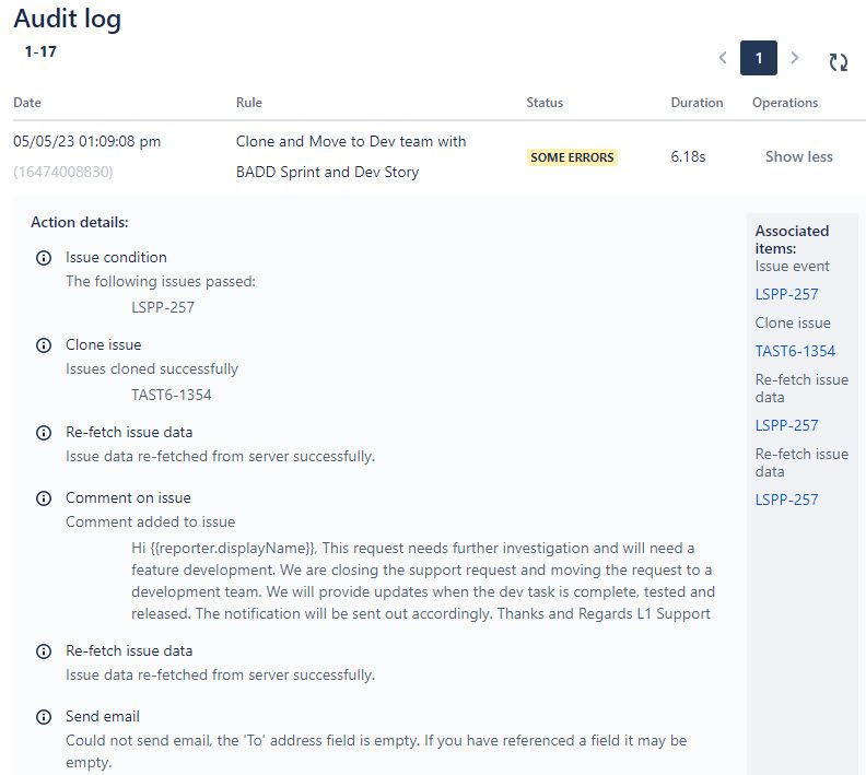

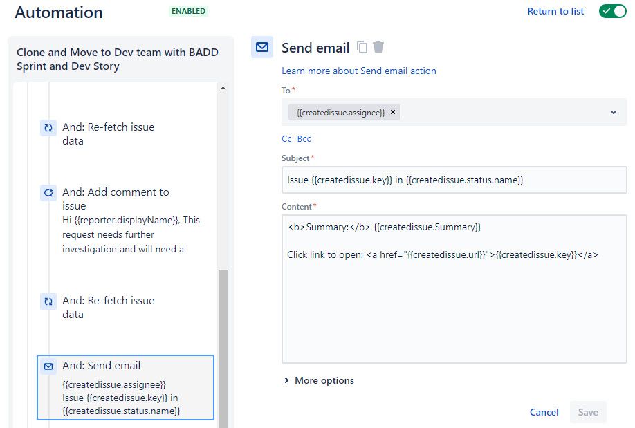

Phil Bustin
May 5, 2023
Still working on this, but it would appear that even though the assignee was set by me to myself in the Move to Dev Team transition screen, assignee is apparently unknown to the email component, because it causes the error below.  Assignee is not among the fields modified in the clone detail.

Trudy Claspill
May 5, 2023
Use a Log action to print the {{createdIssue.assignee}} value to the Audit log to see what the actual value is. Typically the assignee attribute returns the user's unique account ID, not their email address. To get their associated email address you need to reference another attribute. Refer to this documentation.

I got the same empty assignee error using {{createdissue.assignee.displayName}}, that I found in the Jira Smart Values - Users link you provided.

You received the error because the smart value you provided (displayName) is not populated with an email address. For the To field of the Send Email action you need to be providing an email address. Use the emailAddress attribute.

Phil Bustin
May 8, 2023
It's working.  Thank you!
