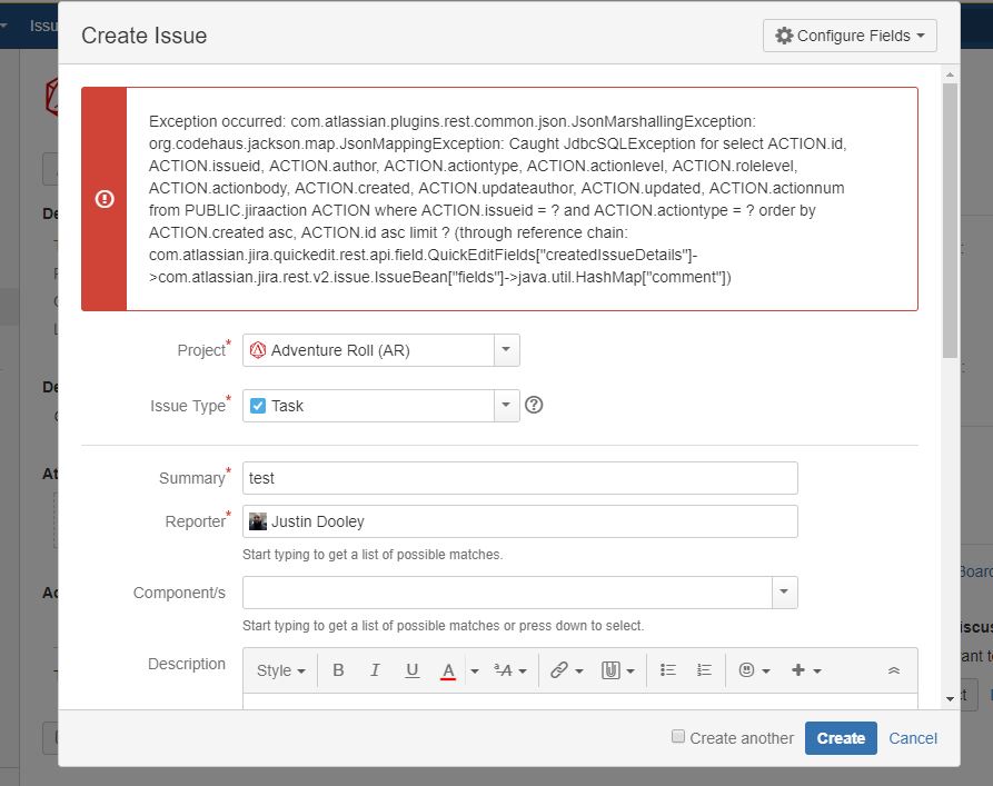

I recently upgraded Jira to a the latest version but the database seems to have a few issues. I get an error on my health check that says the following. The strange part is that from mysql, the function runs correctly. The database is set to utf8 and the tables/columns are set to utf8_bin. I've verified this in the terminal. This does not stop new issues from being created. It just returns an error when quickly creating an issue. The issue does get created if you refresh or navigate away though.

While it can be common to see this health check warning, that specific error you seen when creating an issue is not common. In turn it could be an indication of other potential problems here. I think it would be best to try to follow these steps as a means to make sure that your data and your database is using a collation/encoding that Jira is expecting.
By following these steps you can then import your previous data into a supported database with the correct database setup.
I have seen these steps are typically the best to follow in order to make sure you can still maintain your data and get everything into an expected format for Jira. The really important part is to make sure that you follow that database setup guide when creating this database, such as https://confluence.atlassian.com/adminjiraserver077/connecting-jira-applications-to-mysql-945532531.html
Please try these steps first. I would be interested to know if these steps can help resolve both the health check warning and this error message at the same time.
