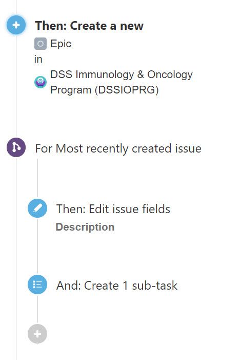

@Bill Sheboy - Thanks for the prompt reply! I've added screenshot below. I'm building a simple table. The first row is a link to the parent ticket (initiative). The second is to see a ranked list of tickets within the epic (once I figure this out, I will add a row for open tickets).
The audit log shows that the ticket was successfully created. It does not show any errors.
Regarding the audit log showing no errors: in many cases when a smart value expression evaluates to null, there is no error.
I am guessing in that Issue Create action, you are trying to add a link to the same issue which is being created. If so, that is not possible because it has not yet been created and so the {{createdIssue}} smart value is null.
A work-around for that would be to add the value after the create:
@Bill Sheboy ,
Thanks again for the feedback. Unfortunately, still struggling to work this out.
I updated the initial description and added a branch to try and update without any luck. I tried to also create a subtask of the newly created task and that didn't work either.
