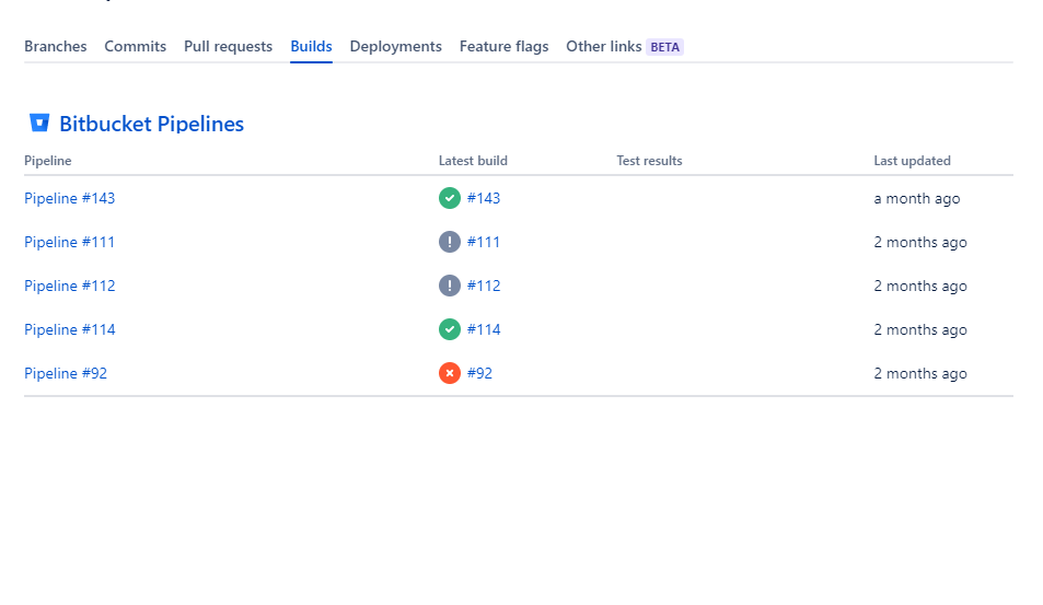

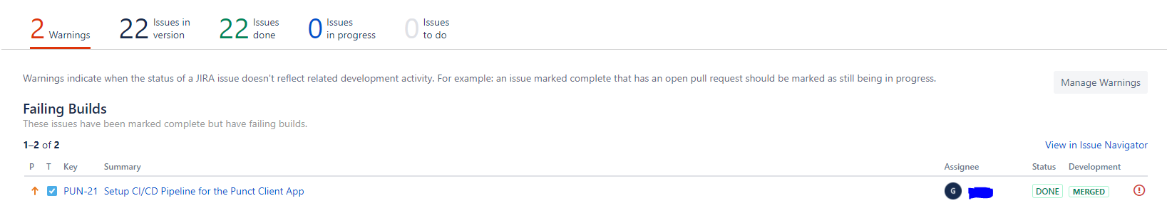

I am trying to make a release and it doesn't let me to go ahead with the build due to Failing builds.
One of the developers in the team worked on a story and he accidentally tried to deploy to Production (It was in the early phases of the project) - That deployment failed.
The issue is that now I can't make a release since it shows up on the warning page of the release (due to that failure). Basically, I don't care about this deployment failure, since anyway he shouldn't be able to promote to production environment.

Thank you for include the details and screenshots for your issue, they're very helpful! From what I can see, it looks like your release is failing due to the build plan that is Pipeline #92. You won't be able to delete this result, but you can disable it with the following:
Repository configuration  >> Pipelines >> Settings >> Enable pipelines toggle.
If you're wanting to delete the pipeline, due know this isn't possible and clarified in BCLOUD-17074
