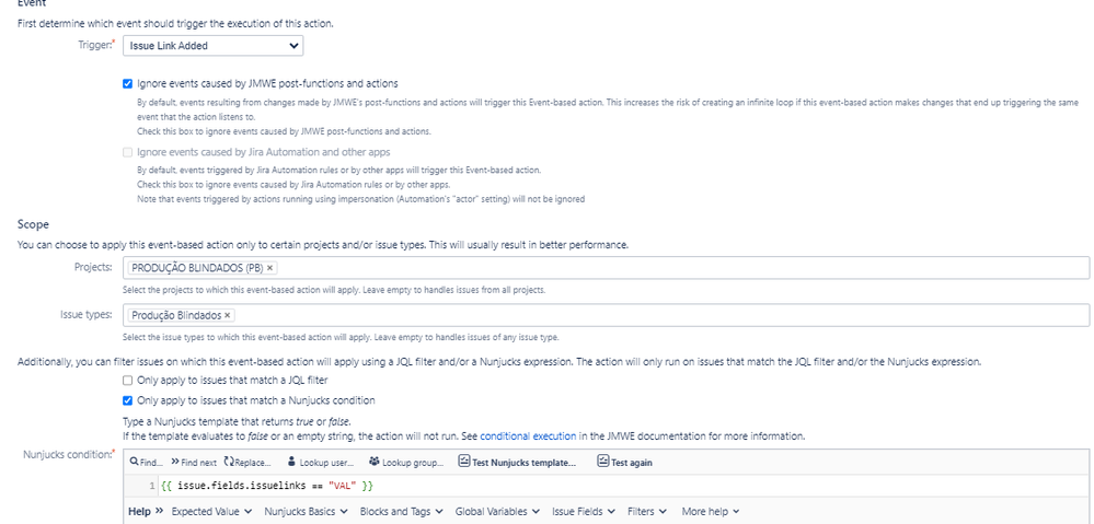

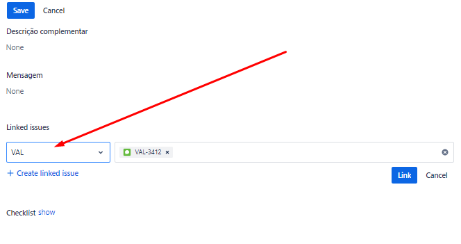

So that's right, I'm making a Pos Function where a condition exists:
Trigger: When an Item is linked.
Pos function: Add a label
Condition: When the link type is: VAL

I also tried Context but still nothing:
David Fischer
October 20, 2023
Unfortunately, you cannot "test" the condition in the post function editor, as the context is empty (you are not currently linking an issue). You need to test it by saving the event based actions and linking issues together
