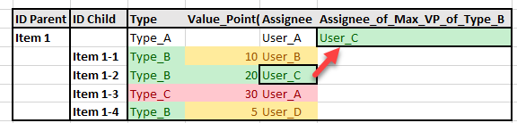

Hello,
I am a newbie in Community and struggling with the following challenge:
I managed to get the max value points of items of "Type_B" onto the top level of this structure (using max#subtree {condition}). But I am struggling with getting the assignee (or any other field) into the top line, that is assigned to a descendant item of "Type_B" with the highest value points (20 in the example).
The example is a bit simplified as there are more levels with parent child links possible in my "real" challenge.
Any suggestions how to takle this. My appreciations in advance!
Georg

Georg Bauser November 10, 2023
Hi @Bill Sheboy ,
Iam using Jira v9.4.11 + ALM Structure
My question is related to ALM Structure. Is this wrong community?
Regards
Georg
Hello @Stepan Kholodov _Tempo_ ,
Thanks for your suggestions:
I think that your formula would return in my example "User_D".
I am not looking for the Assignee with the highest Value if you sort all assignee names.
What I want is:
In a line of JIRA "Type A" return the Assignee of the JIRA Items of "Type_B" that has the highest "Value Points" (=20 )".
Do you have a further suggestion? I would appreciate it a lot!
Truly kind Regards
Georg
