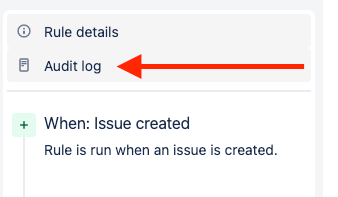

When you are viewing the project look at the bottom of the navigation panel on the left. There is will say "team-managed" or "company-managed".
Rules have an accompanying Audit Log.
If you click on this it will show you a list of entries for each time the rule was changed/published and each time it executed.
If the Status column says "Config Change" that is a record for the rule having been edited and published. The other entries will be for times the rule executed.
Find the entry that corresponds with when you made the change to the child issue. Click the "Show More" link to the right of that entry. That will show the log details for that time that the rule was executed. Please share those details with us.
If all you see are entries with the "Config Change" status, then your rule has not executed. That would occur when the there has been no action that corresponds to your rule's trigger in the project to which the rule is attached.
Another debugging trick is to use the Log action. You can use that action to print text into the Audit Log and to print smart values. That can be very useful to show you what the values actually are and can offer a clue about why results did not turn out how you expected.

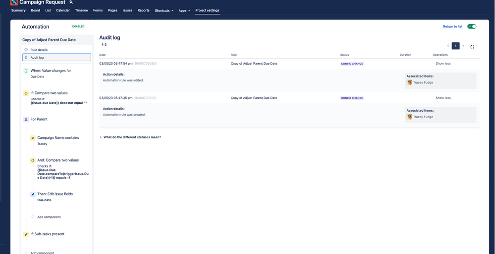

tracey.fudge
May 3, 2023
It says Team Managed.  And all I see are config changes.  See attached.
Trudy Claspill
May 3, 2023
That is an indication that your rule is not being run.

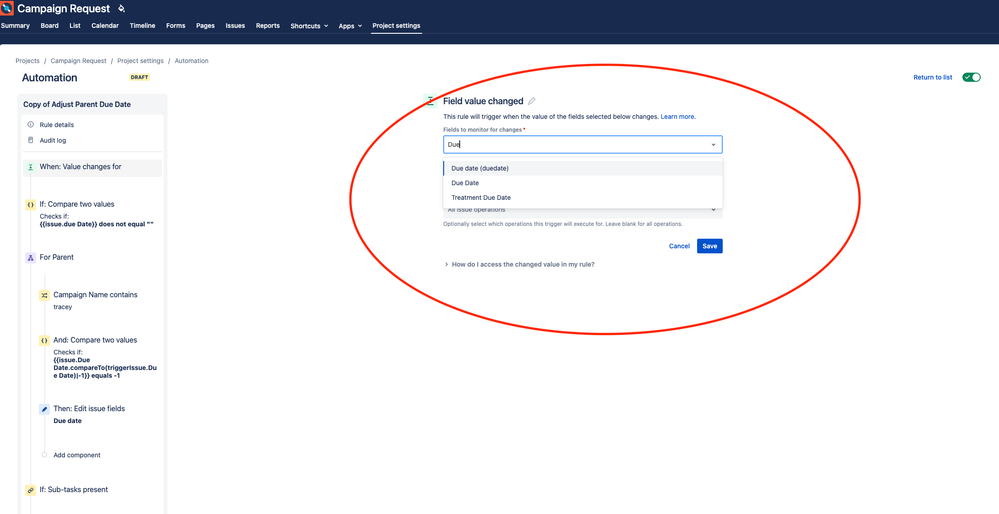

Can you show us an issue where you changed the Due Date? I'd like to be able to see the Due Date field. Other information can be obscured.
I suspect that the "due date" field used in your issue is not the same as the "Due Date" field you selected in the rule trigger.
In your trigger if you search for just "due" for the field to monitor, do you get multiple matching fields named "due date" with variations on capitalization?
tracey.fudge
May 3, 2023
Yes I get multiple 'due' options.
tracey.fudge
May 3, 2023
Trudy Claspill
May 3, 2023
You need to select the one that matches the field you see on the screen. Make sure the capitalization matches. Matching capitalization will also matter when you try to reference a field in a smart value.

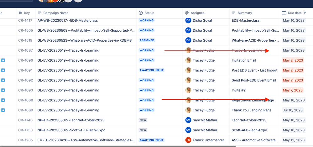

tracey.fudge
May 22, 2023
Here is my progress and more question(s):
THIS WAS DONE (SEE ATTACHED):
Because you are within a branch the context of "current issue" is changed to mean the issue being acted on in the branch. If you click where I'm pointing in the image above, you should get a pop-up that allows you to change that to "Trigger Issue". You want to copy the date from the issue that triggered the rule to run.
Try moving the Log action to the location indicated by the error (move it within the For Parent branch).
NEW QUESTIONS:
1) We only want the parent date to change to a future date, not a date in the past.  Right now the parent date is changing to any new date applied (even in the past)
2) Also, we want the parent date's to change to the 'nearest' due date of any child issue.
3) Can this be set to run on all existing parent tasks as-is, even with no 'new' date entered?  I am testing mine to see if this works, but I am curious if we can run this (once the above #1 and #2 are applied) to all parent tasks.
4) Once testing is done, do I just delete the step "campaign name contains tracey"?
THANK YOU!!!

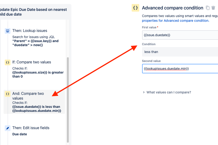

Based on the new requirement, I would structure the rule differently.
In the branch the first step is now to look up all the issues that are children of the Epic and that also have a due date set in the future.
The next step ensures that you have found at least one such issue.
If you have found at least one such issue, then the due date of the Epic will be set to the "minimum" due date from among the retrieved child issues.
If no child issues are found with a due date in the future, then the Epic due date is not changed.
You had a step in your rule to ensure that the new date you assigned to the Epic was farther in the future than the one it already has.
Let's say your Epic had three child issues with due dates of 6/24, 6/25, and 6/26, and your Epic's due date was currently set to 6/24. If you changed the due date on the 6/25 issue to 6/23, would you want the Epic changed from 6/24 to 6/23?
If the answer is "no", then you would want this additional condition.

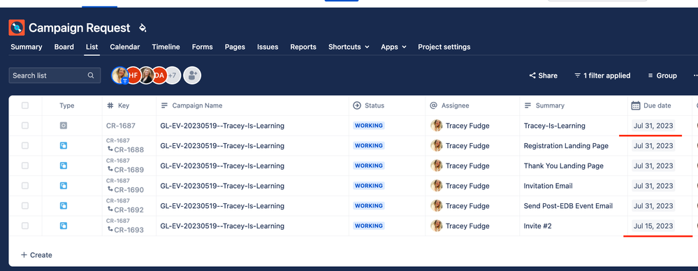

tracey.fudge
May 23, 2023
I did the changes you suggest (or so I thought).  See image:
But it did not work....All of the dates (for parent and child) were set to July 31st.  I changed a child date to July 15 and the parent date did not change.  See image:
