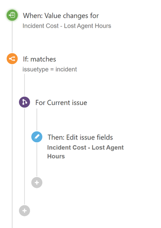

My rule is as follows:
Breakdown of steps:
As you can see I've tried looking at things like destinationissue.xxx and that is giving me the same result as issue.xxx
The tickets in Jira are linked by the link type 'is Problem Ticket for' / 'is linked to Problem ticket'
For the branch, try using For Linked Issues instead of Current Issue.
Then use {{triggerIssue.Incident Cost - Lost Agent Hours}}+{{issue.Incident Cost - Lost Agent Hours}}
