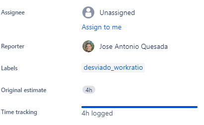

Thanks for your proposal, but it doesn't work.
It always apply the label.
When time logged is greater than original estimate (it's OK)
When time logged is equal to original estimated (it's KO)
When time logged is smaller than original estimated (it's KO)

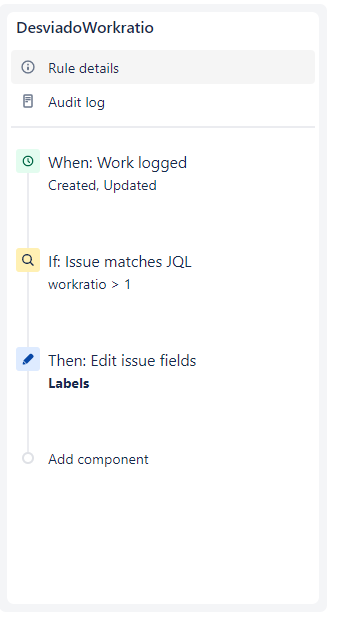

This is the rule configuration:
Thanks,
Jose
@Jose Antonio Quesada,
Thanks for highlighting that! It looks like in Jira Cloud, the workRatio field is actually on a scale of 0-100 rather than 0-1. Try doing workratio > 100 instead of workratio > 1!

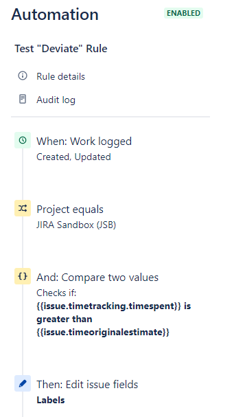

Thank you very much! I've tested it but I can't get it to work.
Jira says the issues does not match the conditions, but the issue is deviated:
The support documentation (https://support.atlassian.com/cloud-automation/docs/jira-smart-values-issues/) shows all the available fields, and I can't find the field {{issue.timeoriginalestimate}}
Maybe here is the problem?
Thanks in advance.
BR
Jose
That list of smart values is not exhaustive. Check out the description in https://support.atlassian.com/cloud-automation/docs/find-the-smart-value-for-a-field/ to find more.
The fields used for the smart values `{{issue.timespent}}` and `{{issue.timetracking.timeSpentSeconds}}` may have different access permissions, but they should both hold the same numeric value (in seconds) as `{{#issue.worklog.worklogs.timeSpentSeconds.sum}}` would yield (which may have other access permissions). If you don’t have sub-tasks or don’t track time therein, `{{issue.aggregatetimespent}}` will also be the same.
The long form would be `{{issue.fields.timespent}}`, by the way, but `fields.` can always be omitted and `issue.` is implied and thus optional much of the time, so `{{timespent}}` will work as well. Smart values also support reference by (non-translated) label, so `{{Time Spent}}`, `{{Remaining Estimate}}` and `{{Original Estimate}}` should work as well, but `{{remainingestimate}}` and `{{originalestimate}}` will fail, because they are actually called `{{timeestimate}}` and `{{timeoriginalestimate}}`, respectively (also available with `aggregate` in front).
