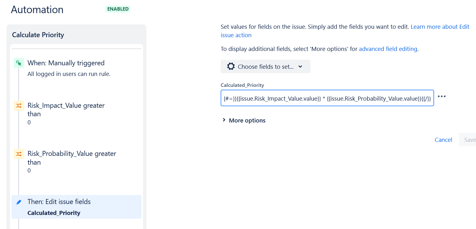

I have set up an automation so that when:
Risk Impact value > 0
Risk Probability > 0
Then edit Priority to be equal to: {{#=}}{{issue.Risk_Impact_Value.value}} * {{issue.Risk_Probability_Value.value}}{{/}}

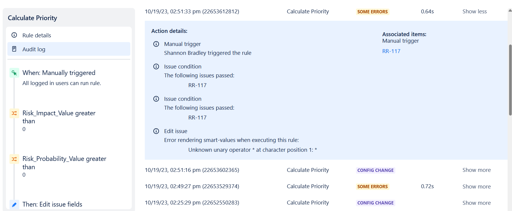

This gets errors
can someone help me figure out what is wrong with my automation?
Thank you!

Hi @Shannon Bradley
That error is telling you the math expression's inputs collapsed to null, leaving only the * remaining.
What are the types of your fields?  If they are numeric, please remove the .value from each of those fields in the math expression, as that is used for selection fields (i.e., drop-down lists).
{{#=}}{{issue.Risk_Impact_Value}} * {{issue.Risk_Probability_Value}}{{/}}
If that does not help, it is possible the smart values are incorrect for the fields.  Smart values are name, spacing, and case-sensitive, and they often do not match the displayed name on the issue views.
To confirm your smart values for the fields, please use this how-to article: https://support.atlassian.com/cloud-automation/docs/find-the-smart-value-for-a-field/
Essentially you find an example issue with your fields, call a REST API function from a browser tab, and search for your fields on the page (e.g., with CTRL-F) to find the correct smart values (or the custom field id).

Shannon Bradley
November 16, 2023
Thank you so much!  The smart values were correct.  It was the ".value" at the end of the field names that was causing the problem.
The automation runs and succeeds now :)
