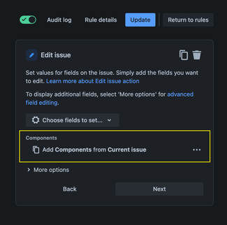

I want the epic's component to be added to the issue's component list, not overwrite any other components the issue was already tagged with upon creation. The documentation has steps for this, called "adding values to multi-select fields." It should work in theory, but I don't have the ability to do what the instructions say.
Instead, in my version of Jira, if I use the "copy from issue" function (called "Add components from current issue"), I lose the ability to add anything else to the field. So I can't add a second component like the instructions state I should be able to. Screenshot attached of what I see.

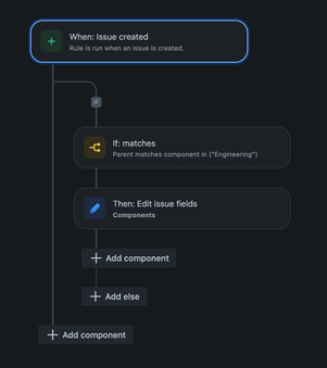

Context is important for automation rule conditions and actions.  And without seeing your entire rule, I hypothesize you have a branching error that is causing this.
Please post an image of your complete automation rule, images of any relevant actions / conditions / branches, and an image of the audit log details showing the rule execution.  Those will provide context for the community to offer ideas.  Thanks!

A rule structure to do what you ask could be:
  • trigger: issue created
  • action: re-fetch issue
    • When using the Issue Created trigger, it is important to follow that with the re-fetch action.  The reason is this specific trigger can fire so quickly that the data is not yet available to the rule, leading to unexpected behaviors and errors.
  • condition: check if the issue has a parent
  • condition: check if the parent has the component you want to add
  • action: edit issue, to add the components from the parent
    • use the ... menu to the right of the field to select COPY
    • select the field to change to "Add Components from Parent issue"

Appreciate your response. Attaching my flow JIC.
I see what you are suggesting in your bullets, but that's mainly what I have. Except for the re-fetch action. Do you think that would cause my automation UI to change?

When changing the Components field with the built-in editor, you are correct that you may either set the values (with add / remove) or copy them from some other issue...but not both at once. A work-around if you want to do both is to edit using advanced edit with JSON, as described here: https://support.atlassian.com/cloud-automation/docs/advanced-field-editing-using-json/#Components
You can directly enter the Components when using the SET option; that will then show the drop-down list as in your image from the documentation.
