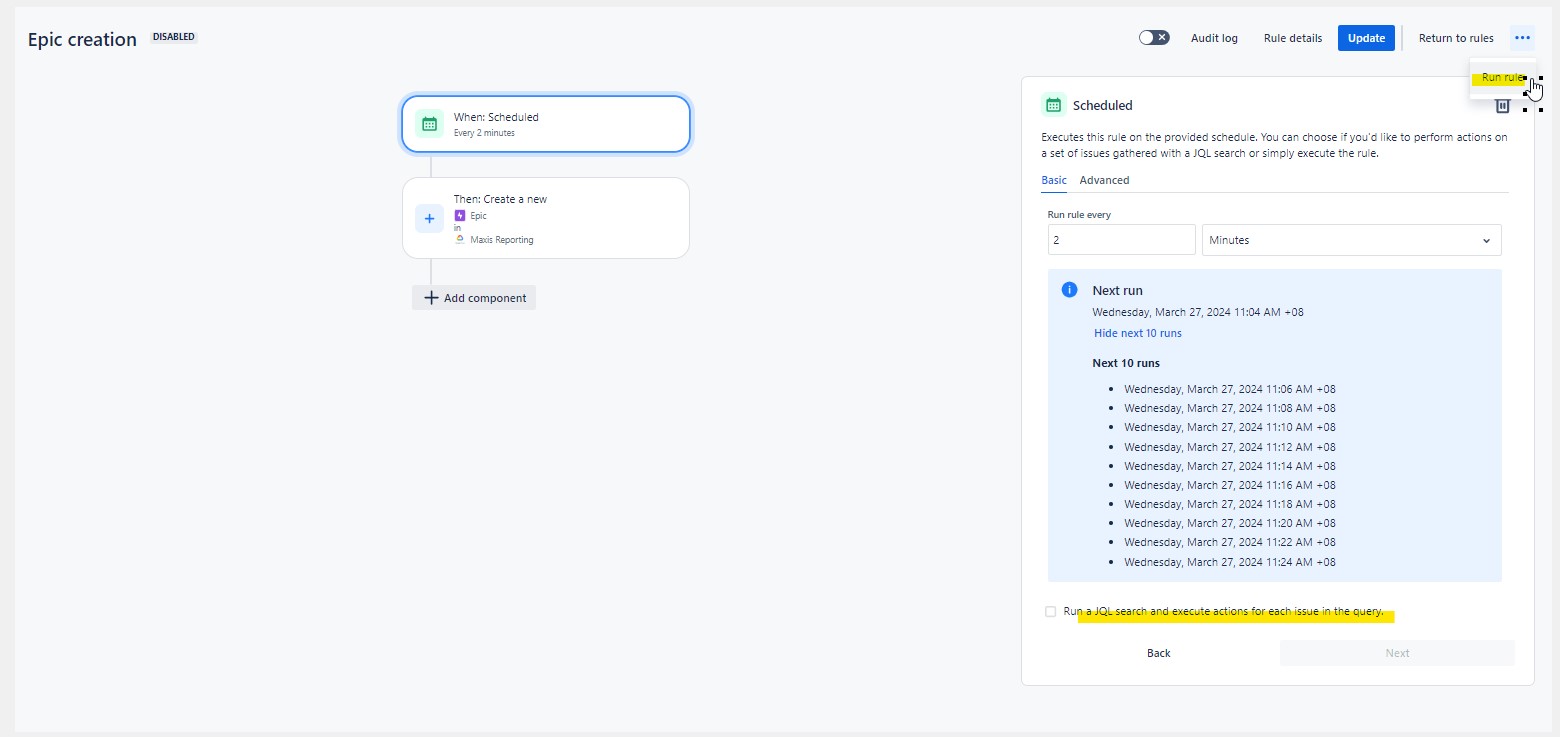

So this automation i plan to run under the automation trigger "When:Scheduled" for every two weeks on a Monday and will create a new Sprint Epic 4 weeks ahead (eg. on 8 April morning, the automation will execute and create a new Sprint Week tittle of 4 weeks ahead with tittle "Sprint Week 19" which starts from 6 May till 19 May 2024).

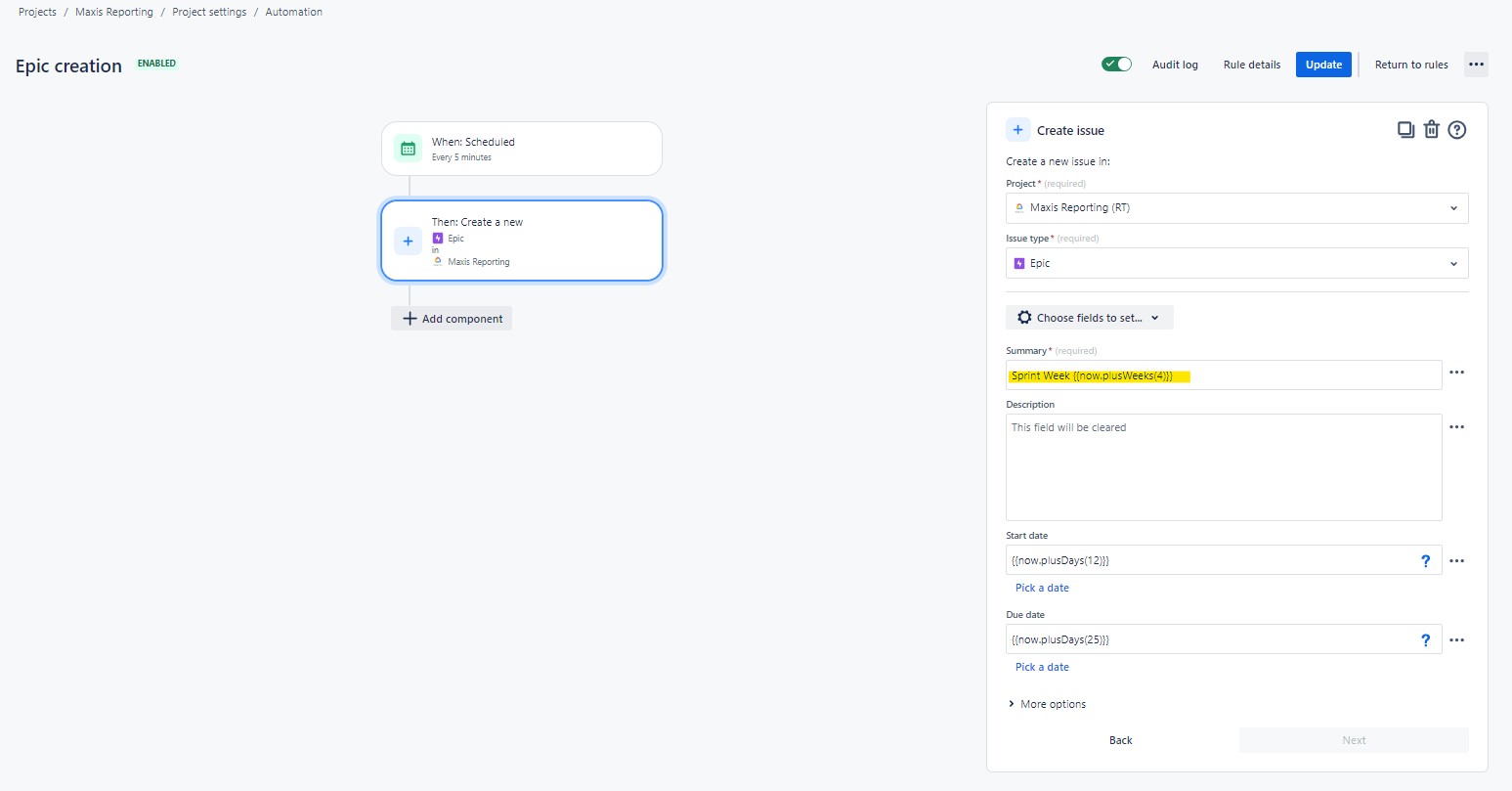

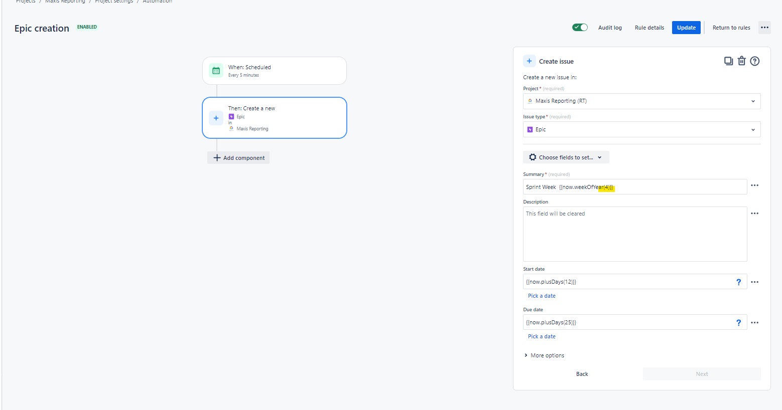

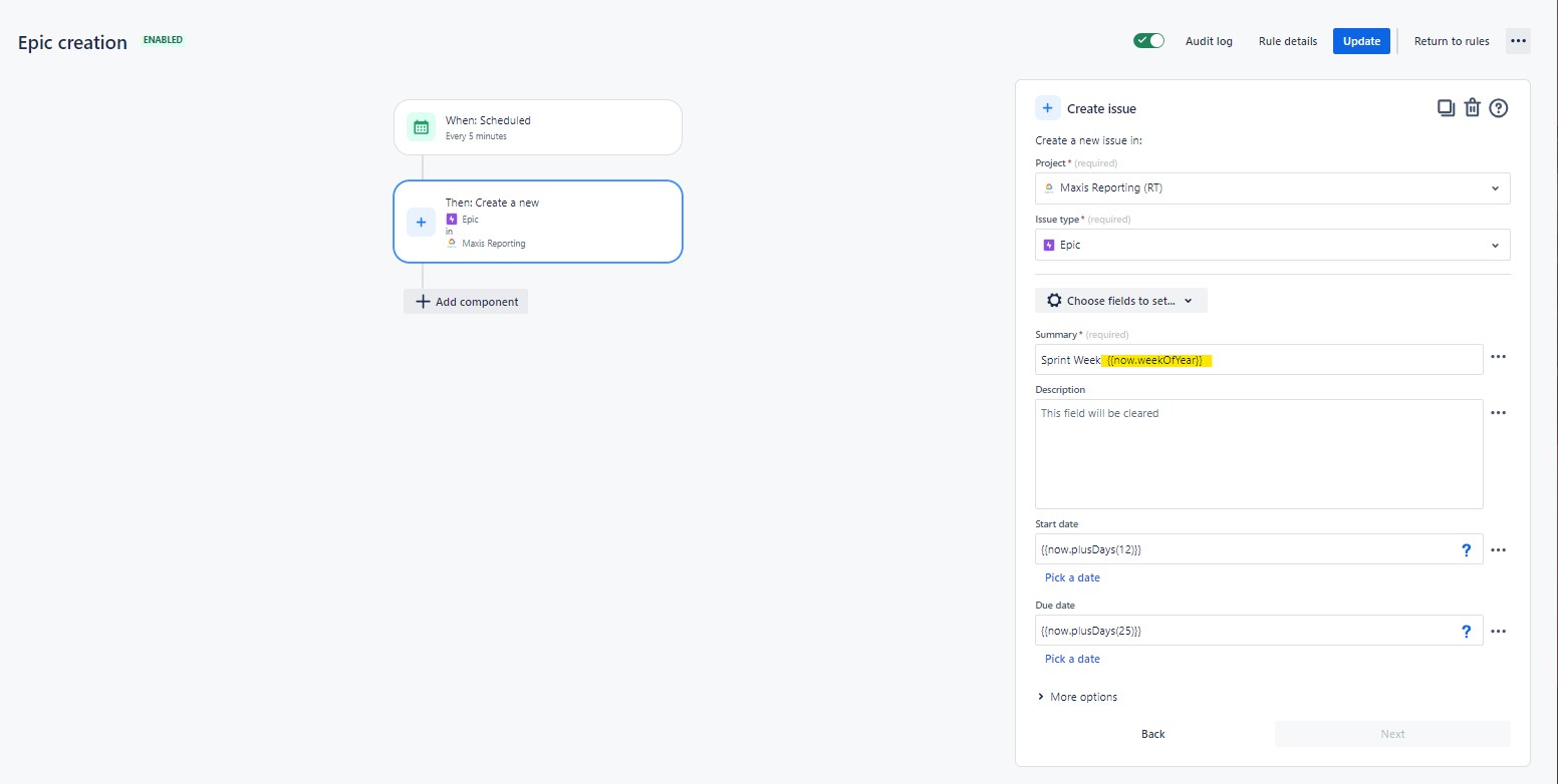

This is what i had configured but not able to get the naming convention right (as i could get the current week of the year but not get the future week number). @Guy Anela i think the rule was not running even when i did the "run rule" force manually is either due to the JQL search (which i had removed asper screen short mock test VS the original i did as per screenshot schedule). But i did also specify the project as per your advice (did not use the original "same project").
Also to set the Epic start and End date, is there a more suitable/efficient Jira Smart Value feature than "{{now.plusDays(x)}}" as the 2 weeks i may not always "start on a Monday/end on following Sunday" during end of the month as the different number of days in a month.

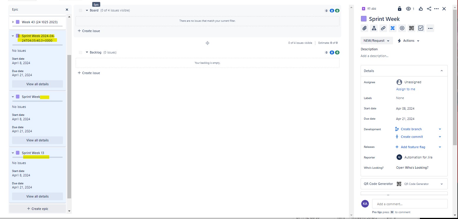

To get the start date included in the title (as per current "manual epic/sprint creation naming convention), I have updated the "Summary" with
Sprint Week {{now.plusWeeks(4).weekOfYear}} ( {{now.plusWeeks(4).format("dd MMM YYYY")}})
So as example when i execute it today, i will get the Epic tittle name as below screenshot (identical with current :)).
Which the actual Start Date & Due Date will actually be correct if i run this automation on the Monday so the Start Date will be on Monday 29 April 2024 and Due Date will fall on Sunday12 May 2024. (compared now it start on Friday date and end on Thursday date)
So just make this automation not depending on the day of when it is executed so that the start day always to start on the monday of the week & end on the Sunday of the following week, can i use jira smart value "startOfWeek" or "endOfWeek(-1d)"?

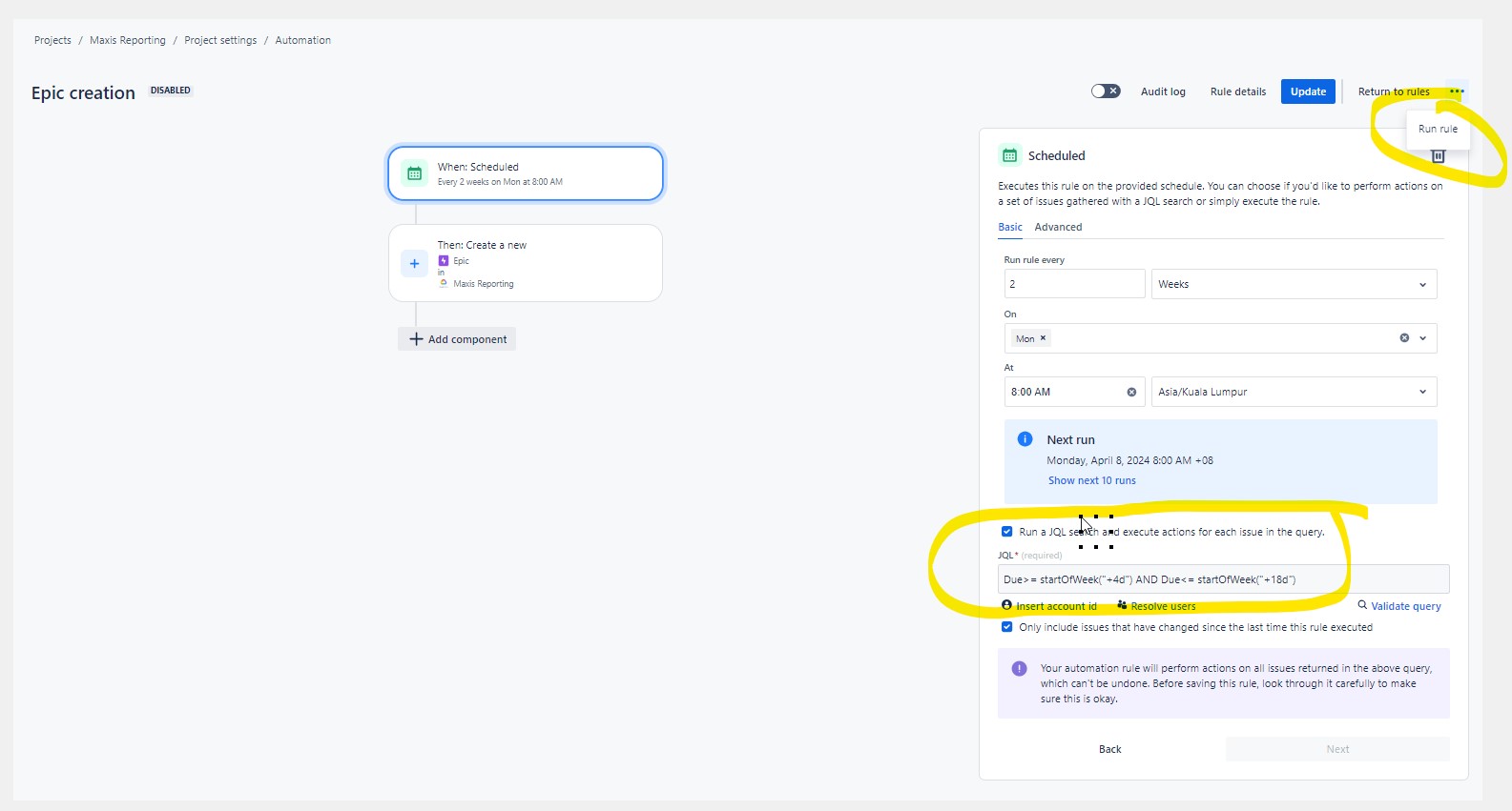

sorry, seems the screenshot was not attached when i thought i had inserted earlier (which i had not as did not press the button) for reference. Here it is. sorry for the inconvenience
