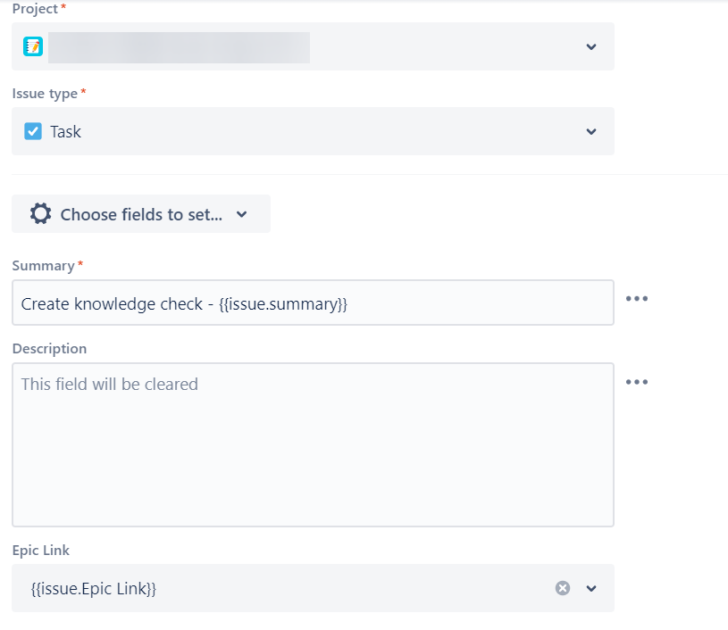

Trying to create a new issue for an epic, but I want that issue in a different project. The problem is it won't associate the issue with the epic.

We used to trigger automation through components. I tried to trigger this one through the manual trigger trigger from within the epic. Ideally, I'm creating the epic and at some point, in time I want to create these tasks for the other project.

I'm going for the latter really. In which case I'm using the manual trigger. The problem is that the tasks aren't getting associated with the epic link.

So that's my question. What can I do so the automation knows to associate that epic? I tried using {{issue.Epic Link}} and starting the automation from within the epic with the manual rules. Should I create a field that exists within that epic? I feel the issue is that the the new tasks are being created in a different project.

So the project manager is in an Epic, then clicks on the execution of a manual automation rule, and it creates the children stories identified in the rule (regardless of the project). Is that correct?
If so, what I showed you above is what you should do for the Epic Link field in the children getting created.
Daniel Caspy
March 23, 2023
@John Funk It worked perfectly. Thank you so much. I didn't understand I needed to put it in the epic link. Much appriciated.
