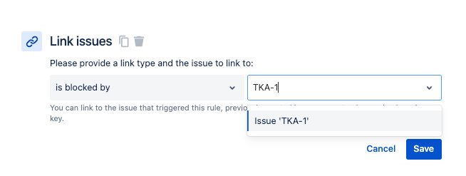

I am trying to create an automation when a bug is raised and assigned to a specific person it links to a specific story.
When I try the automation tools the only options I have for linking to is either link to the trigger or most recent issue created.

If the issue per Assignee is a fixed value that can be hardcoded, then yes, and If-Else block could be used to look at the Assignee and then link the trigger issue to an explicit issue. In the same manner as adding a smart value, you can click into the space that says Trigger Issue and start typing the issue key for the target issue.
I believe you're trying to link to a specific issue (ex: ABC-123).
The UI here isn't super clear. When you initially open that dropdown, it'll only show you "Trigger Issue" and "Most recently created" as you've seen. What isn't immediately obvious is that if you click into that box and start typing a key (ex: ABC-123), there will then become an option to link to that specific issue.
