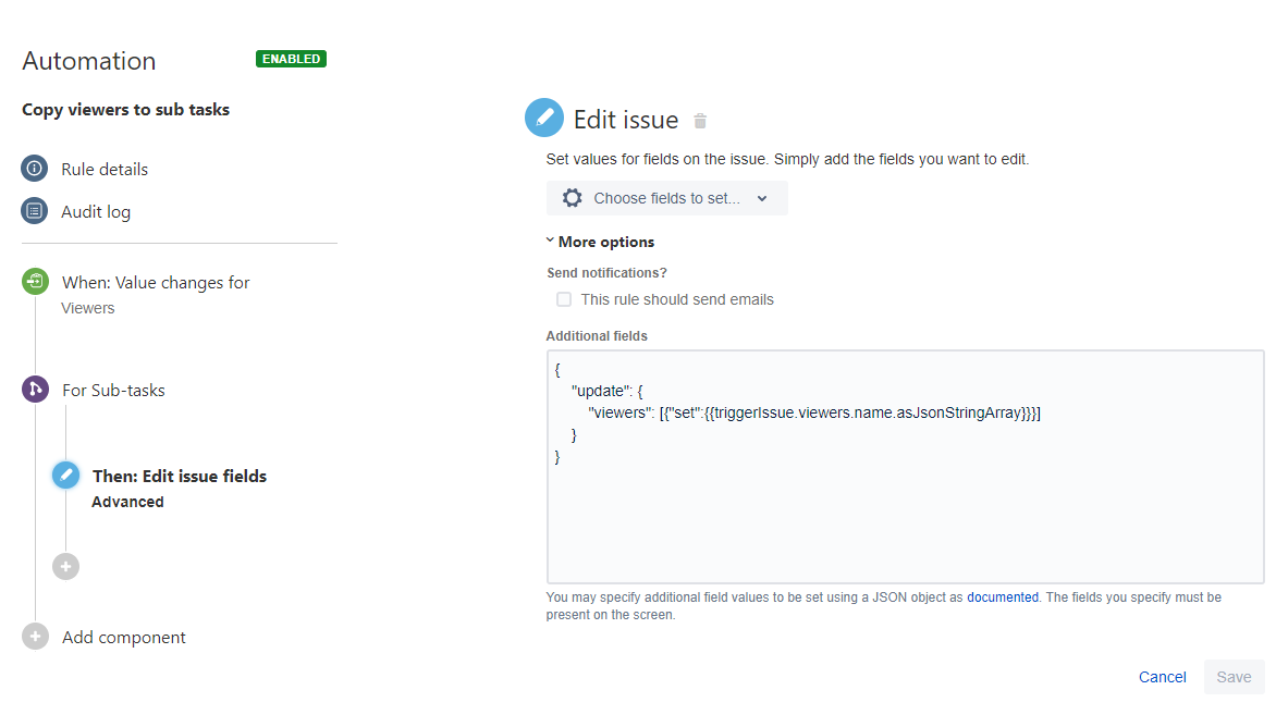

I have custom field Viewers. It's an array of Jira users. One issue can have many users in Viewers field.
I need to add automation to add all users from parent Viewers to child Viewers.
Could you please help me to specify an additional field correct?
That's how I already did it:
But it doesn't work. Log says:
A couple of things to try would be to add a Log action before you set the field to see what that call to asJsonStringArray is returning.
Next, perhaps try just set it directly (without the coversion to the array) if both Viewers fields are list fields.

I agree with Bill, you should just try the built in function to copy value from Parent issue. It even has the option to "[x] Add to existing values" in case you don't want to overwrite any subtask viewers:

asJsonStringArray is returning list of users, for example:
triggerIssue.viewers.asJsonStringArray: ["testuser","samruk"]
I tried to set it directly:
"edit": {"viewers":"{{triggerIssue.viewers}}"}
And get an error in the log:
No fields or field values to edit for issues (could be due to some field values not existing in a given project)
So it still doesn't work(
Hi @Darryl Lee thanks for the advice. I can't choose field Viewers using Built-in function. That's why I use the Advice section. But I saw on your screen you could choose Viewers field, how did you do it?
You may need to use the custom field number/name in your JSON rather than the people-friendly name, Viewers. Please talk to your instance admin to learn the custom field name and then try that for the edit.

How about this syntax which should iterate over the trigger issue's viewers and add their JSON using the id values:
"fields": {
"viewers": [
{{#triggerIssue.viewers}} { "id": "{{accountId}}" } {{^last}},{{/}} {{/}}

@Bill Sheboy thanks for the advice.
I've tried custom field number/name before, and it didn't work too.
Syntax which you wrote works! But unfortunately not as expected, it deletes all Viewers from a child task. Will try to modify it but I'm really not good in JSON so hope your link will help :) Thanks!

@Alena Samruk Sounds good... To help diagnose why the field is being cleared rather than filled, consider posting the new id values with the Log action rather than updating the field. That should rule out part of the cause.
@Alena Samruk I was going to suggest reaching out to Support, because this is weird. But then I dug around. Is this a Next-Gen Project? As with many things (:-( that's probably the problem:
https://jira.atlassian.com/browse/JRACLOUD-75792
I wonder if "add" would work here, as documented in that bug. So then:
"update": {
"viewers": [
"add": {{#triggerIssue.viewers}} { "id": "{{accountId}}" } {{^last}},{{/}} {{/}}
If not, then maybe you could try *ALSO* iterate over the existing viewers:
"fields": {
"viewers": [
{{#issue.viewers}} { "id": "{{accountId}}" }, {{/}}
