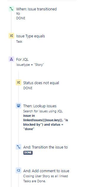

Thank you for those steps! I've written this rule (found something to base the JQL off of since I'm not good at JQL). The Audit Log shows Success but when I look at the details it seems to run through hundreds of Tasks, so I'm off somewhere -- I got tripped up at the advanced compare condition and how to write that. Where am I off? Does the advance compare condition happen in the branch, or back out?

Well...the JQL for that branch needs to be more specific to narrow things down...Otherwise it will try to yank in every story!  Let's narrow that down to linkedIssues to the trigger issue which are stories:
issue IN linkedIssues({{triggerIssue.key}}) AND issueType = Story
Next for the advanced compare condition on the lookup...You are checking if there are any non-done issues, so...
  • for the Lookup Issues, the JQL would be
    • project = myProjectName AND issue IN linkedIssues({{issue.key}}, "is blocked by" AND status NOT IN (Done)
  • and for the advanced compare condition check if the count is zero...
    • first value: {{lookupIssues.size|0}}
    • condition: equals
    • second value: 0

Updated the rule to this, but it's still yanking in all User Stories and it's closing the User Story before all linked Tasks are marked Done.
Also, we do have one other Status value that's considered "end state", which is "LIVE (Launched)" so I've added that in because the rule was changing User Stories in Live (Launched) to Done, which we don't want.
Also note that I've checked the box for "Check to allow other rule actions to trigger this rule. Only enable this if you need this rule to execute in response to another rule.". Is that correct?

Please note I was suggesting to change the JQL for the branch and for the lookup issues.  It seems you did not change them as I suggested, so please try that from my last comment.
To be clear, the JQL for the branch could be:
And the JQL for the lookup issues could be:
project = OSP
AND issue IN linkedIssues({{issue.key}}, "is blocked by")
AND status NOT IN (Done, "LIVE (Launched)")
Also, there appear to be two lookup issues action in your rule, and you only need one for this use case, using the above JQL.
Regarding the option "Allow Rule Trigger": only enable that for a rule when you expect changes from one rule could trigger another.  For example, if any rules can transition a Task to "done" you could enable the option for this rule.
As a tip, automation rules can take work to get correct...while under development that can break a lot of things quickly  :^)  So it is a good idea to create rules in a test project (or even a free test Jira instance) until they are working as expected, and then copy them over to your "production" projects.

Apologies for my last rule; I think I was brain fried when I put it together.
I do have a sandbox to test in and using your latest rules it now works like a charm. Thank you very much!!!!
