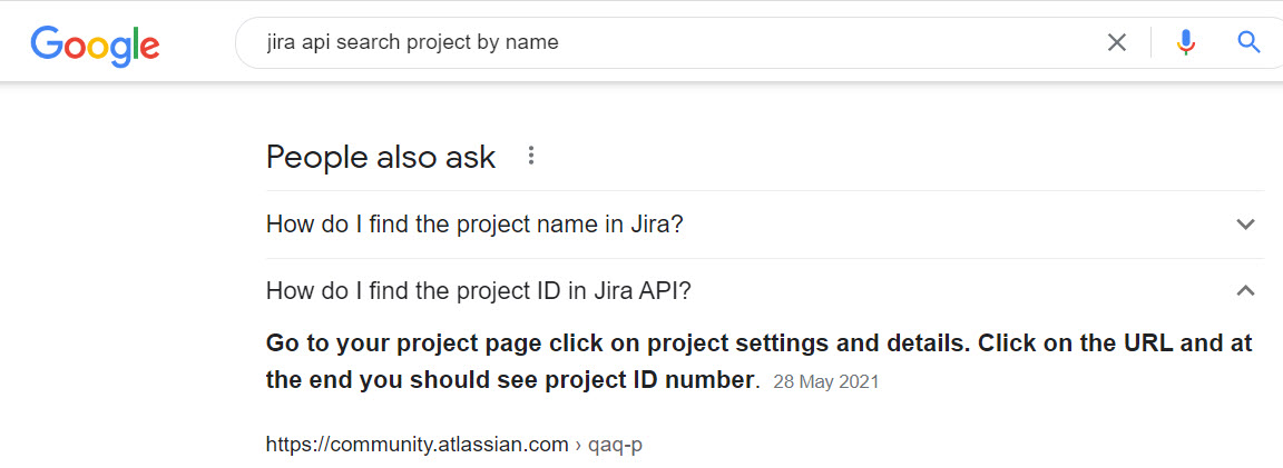

Google search does not help either.
The most funny answer was this:
